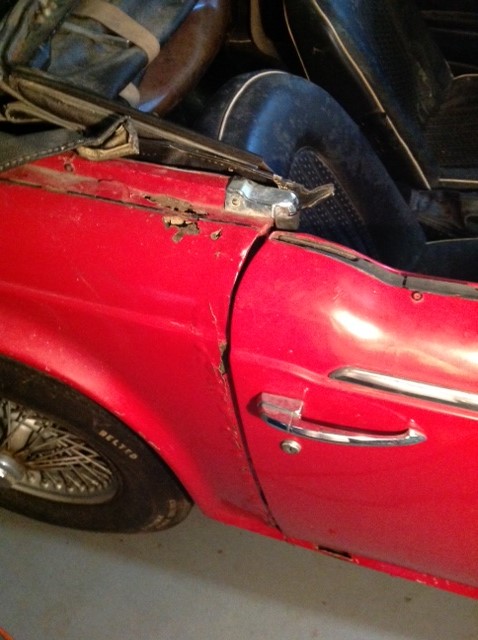

Ok guys I need some opinions. I have the option to buy a tr250 thats been in storage since 1973. The motor is stuck and I will not be able to go see the car until this saturday so I do not know any more than what the pictures show. The owner claims that there is no rust in the floorboards but that the rear section of the rocker panels is rusted out and need replacing along with the rust shown in pictures. He said it was stored on a concrete floor. He owned the car and sold it to his cousin in 1973 who put it in storage, he bought it back last year and has done nothing with it. Price would be $5000
Some other important info, I'm already restoring a TR3a with mechanicals done but no paint on the body yet. I also have a TR4A that is a nice quality driver, so I have plenty of cars to keep me busy.
So what do I do, a factory red 250 with original overdrive seems hard to pass up even with rust problems. I'm aware this will cost between 20-25k to finish properly.

I purchased a TR250 for $2500 and was in a lot better shape. $25,000 to restore is about right. If you do all the work yourself. A lot will depend on how bad is the rust. Check the frame and rear diff. mounts. Like nGeo Hahn said you do it for the love. Triumphs (all LBC's) are not investments. They are for the fun of the drive, and the smiles on the people you pass.
mrv8q
I love 250s, but that amount of body rust would scare me, and 5K seems mighty spendy!
With that kind of rust in the upper pillar/post area, look the frame over very closely. 250 frames have always been bad to rust in the back, even if the tub looks good. It can be saved but at what cost. I'd be interested in it for parts but not at $5k.

As Marvin indicated, definitely check for frame rust especially where the rear trailing arms attach and the rear extensions. Above the rust you can already see in the rear fenders and inner rear H-section, frame rust will definitely increase your cost to restore. I'm surprised to not see any rust in the lip of the trunk lid given how bad the rear fenders are.
Let us know what your find when you get a chance to look at it.

Looking at pic #2 sends a shiver down my spine. That border around the dzuz fasteners stays there when the fender is removed. Short, rolled sections like that are visible after repairs, and, as such take a lot of time to get right.
As cool as 250's are, this car is what I would call a PROJECT.
If you are in, get it as cheaply as you can.
Good luck to you.

It appears that most votes are similar; Buy it for $500-$1K or walk away. There sure is alot of rust & in all the critical places without looking / seeing the Frame.

My thoughts were right along what Marv said, I looked at it and said "it's worth 2k to 2.5k as a parts car, no more" It's in far worse shape than my TR6 was when I bought it for 4k (mine was driving and on the road) and I was already 15k into the resto before I started on the body work (which is when mine turned into a Hunter roadster instead, the body under the quarter panels was so bad)

Its marked as an O/D car, that is a plus, it doesn't look too much different from mine when I started, mine had a few TR6 bits cobbled on, but the rust was not quite as bad (as far as I can tell from the pics). Since the car needed everything I just ordered the parts from the Roadster Factory each week as they went on sale, lucked out with two good used rear fenders I got locally and cheap, had a motor that needed minimal machine work, and probably spent about 10-12k redoing everything, all my own work. It indeed looks like quite a project, if you can weld or want to learn and have lots of time you can fix most anything on a TR as it all comes apart, but lots of time and work. Even project TR250s bring a lot of money, but still think I overpaid for mine, unless you really want to get started now you might want to consider shopping around more, in other words do as I say, not as I do......

I had expressed interest in this one too . I'm glad I didn't waste a trip (about 150mi.) Its too bad but a restoration isn't justified. I don't think $25,000 would fix the body.

Not sure it would be a restoration project in my book. You can find better starting points and be money ahead.
