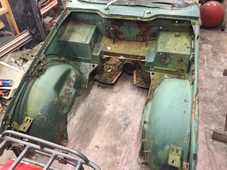

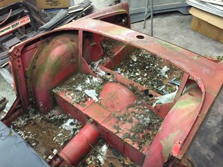

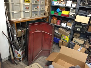

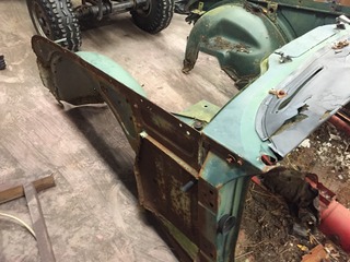

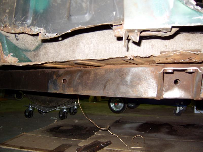

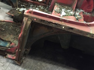

Here's what I brought in the garage yesterday.

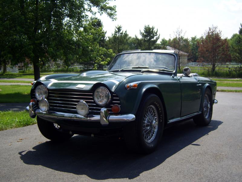

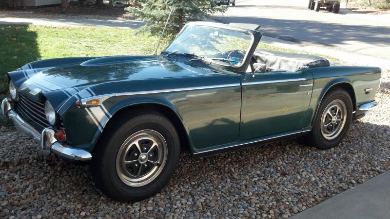

It is wonderful to see what I consider the greatest of the TRs coming back to life.
I spent over 10 years of my life restoring mine.
It is a work of pure love and I hope yours is as well.
Just for some motivation I have included a few of pictures. One of before and two of after.
attachment.php
attachment.php
attachment.php
