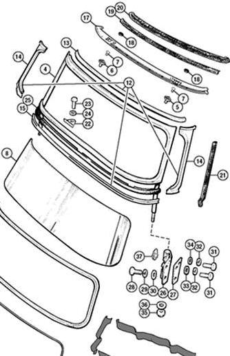

I need to remove the windshield frame on my 71 TR-6 in order to install new a new rubber seal. I have removed the 2 nylock nuts from the studs under the dash. What is the next procedure to free the frame?
Gliderman8
Don't forget the two domed bolts at the base of the glass on the dashboard... #23 in this diagram.

hondo402000
I think you also have to loosen the bolts number 31 as they pinch the rod, located when you open up the doors you will see the bolts I ended up using my impact guy with a rod in it to get the frame out
