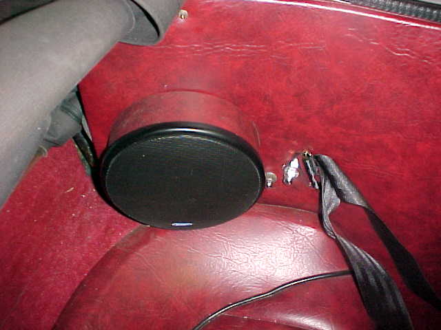

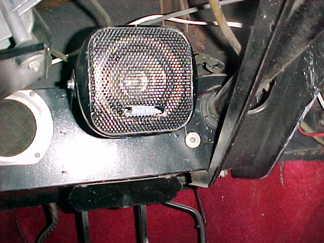

front drivers side,all the speakers are "west marine" the first pict. of the rear are "jensen" i bought them for $12.00 at circuit city to experiment with,once i got the placement right i put the west marine types in, much better sound.

gegw,hold on a sec. gadda pull my collar up its ketin kinda windy in here! "monsoon" there not computer speaks. are they? i cant judge the size of em from your pict.hay if they sound good use em,nice design,i think that unless one ops for a system that cost in the range of $500.00 plus, whatever we use will be a compromize,but ive been able to achieve a level of sound im very happy with especially for what i spent-brand new radio that came with a roof mount that fit perfectly under the heater box,come out of p.u.truck i bought for the snow, free.-rear spks.$57.99-front spks.$43.99. is it a "bose" super dooper? nah,is it a ""boom box blaster"? nah,does it hide away and reappear at the touch of a hidden button? nah.it just does a very acceptable job of reproducing any type of music.gregw,ya godda here it when i play jimmy hendix's tune "1983"! /ubbthreads/images/graemlins/grin.gif

Hey ya Anthony,

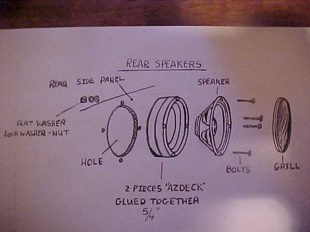

Looks like a clean installation, I like that you matched the interior on the speaker box. Glad you found a solution youā€™re happy with, definitely a challenge with these little cars. Yes, the Monsoons are for my work computer. Theyā€™re 4 Ā½ā€ x 7ā€ and a little less than Ā¾ā€ deep and sound great with the included sub (which I wouldnā€™t use in the car). Iā€™m not sure what the ohm or max watt rating is for them, so they might blow in more ways than one hooked up to a car stereo. Oh, what size are your rear speakers, 6 Ā½ā€?
A
grgw,rears are 6.5 wide,and 2.5 deep,from face to magnet,hence the double thickness of 5/4 azdeck,they also have a 2" center mylar tweeter.4 ohms,160w/pair,come in white or black grills.thanks on the compl.on the material,i found a large piece behind the door panel when i was fussin with the window winder-upper stuff.did i mention there waterproof?.unless you dont care about those nice comp.speaks,id try and find out what thier rated at,or youll be drivin along listening to a favorite tune when all of a sudden youll think you got a cat scatching in each ear.! /ubbthreads/images/graemlins/savewave.gif

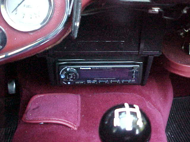

higgins,doesnt the 106 have the same heater box as my bj7,if it does this would be the place to mount it, see atch.
higgins
Hi, you're right but I've removed the heater box as most of the heating was missing anyway.
A such, I'm searching for an ideal place to instal the radio without it looking like it was just "placed" there. We're getting into esthetics now
A
higgins,i understand your plight,a radio for these cars was an option and the under the heater box is were it was originaly mounted,my car came from the factory/dealer with an original a.m motorola unit,i just changed it to am/fm c.d. player,some owners have talked about mounting radios/amps etc. in the trunk/boot with a remote operating device,perhaps one of them will chime in here,there is a thread devoted to this topic you can "search" i believe its the same title "the sound of music" lots a good ideas and info. good luck! /ubbthreads/images/graemlins/savewave.gif
