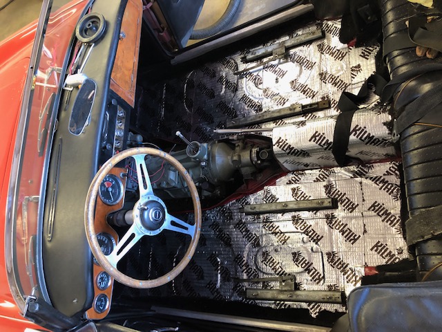

I just finished installing Kilmat in my BJ8 (after rust-converting and painting the floor pans). This is apparently a Dynamat knock-off that is considerably cheaper, and made in good ol' Russia! Quality was excellent, and 25 sq ft was sufficient to cover the floors, sans the firewall:
I covered the Kilmat with furnace insulation, glued Al surface to Al surface, then put new nylon Cocomats on top (got tired of the rubber floor mats sliding around). I haven't driven the car much but, certainly sound has been deadened as I'm now hearing sounds I didn't before (uh oh). I think doing the firewall, i.e. the inside of the pedal boxes would cut sound even more. I don't know how much of the noise in a Big Healey is due to floorpan resonance and not wind or exhaust--I have a loud one--noise, but is has to help some, and the furnace wrap cuts heat and keeps the Cocomats from sliding around (they have 'nubs' on the bottom):
https://www.homedepot.com/p/UltraTo...er-with-Recycled-Cotton-30000-11406/100656748

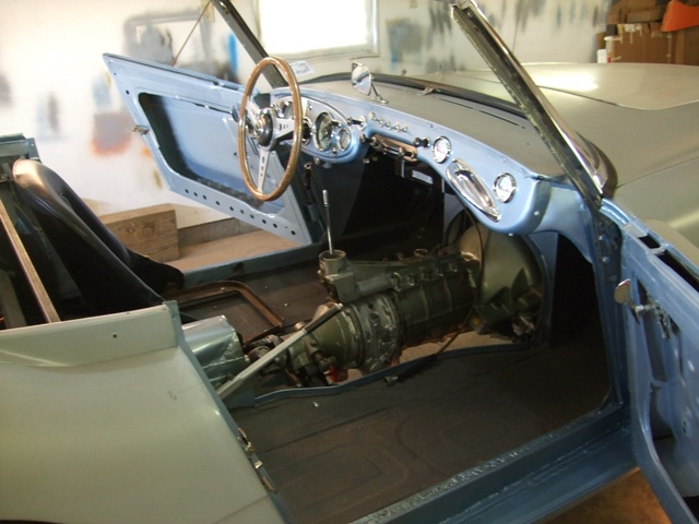

I also went with Lizard Skin. Two different products one a heat barrier the other a sound barrier. I'm very happy with the results. My interior stays pretty comfortable and never too hot. When you spray it on it is very wet and you think it will never dry, it is water based. But it drys perfectly.
This what it looks like:
