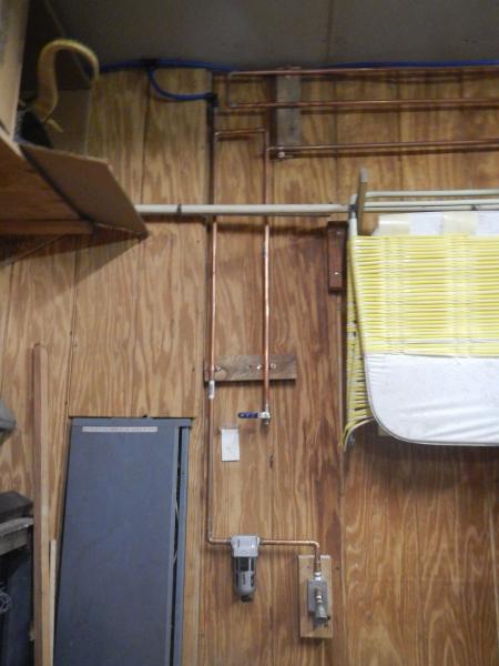

DavidApp

Painting seems to be an exercise in frustration. Imperfections that are not noticed in bare metal standout in primer. Then when they are fixed and it looks great the first coat of finish paint shows a whole new crop of imperfections. It may be we are focusing on smaller and smaller details as we go.
Today I was putting the final coats on the passenger side wings and door. Everything went great till the last coat on the rear wing and door. As I was almost finished the wing I noticed a water drop and thought it is not forecast to rain. Looking at the wing it was covered in small pimples. I am not sure where the water came from as my water traps were empty.
Re-sand tomorrow and get a gun mounted water trap.

DavidApp
Hello Graham
I always drain the tank first thing and last thing when using the compressor. Here in Georgia the humidity is a challenge. I also have the John style copper pipe water trap. (A long length of copper pipe with a drain at the end) Then I have a water separator on the hose connection as well.
Been spraying for the last few weeks with out this issue and in fact it is a little less humid now.
Murphy's law I think. Last coat on the wings lets mess him up.
David

DavidApp
My primary water trap The vertical pipe on the left leads to the spray gun connection and the one on the right to a drain.

I cannot see your whole water catching system David, so this probably is not relative, but from my perspective the horizontal pipe could help hold water. I was thinking maybe angle it down some towards your drain, but I do hate to be critical, really. The way I see it is we are only probably spraying paint 3 times for 5 minute burst and your water system should give you that much time, so maybe it is not draining.
steve
Bruce100
The horizontal is, i assume, on a slight angle with a trap down length and valve. The importance is the length and diameter of the pipe, allowing plenty of time for condensing the water out of the air. I have a similar system.

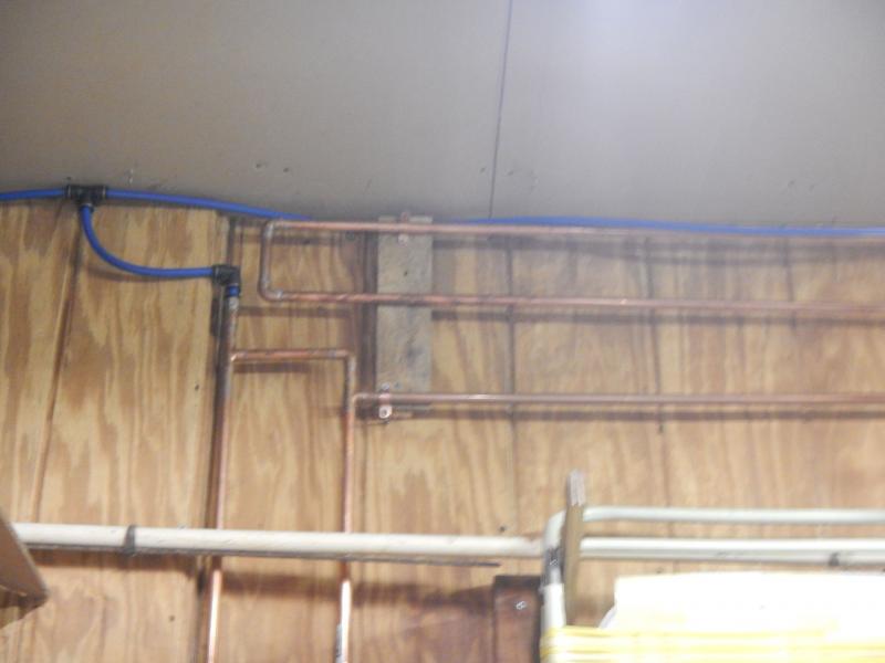

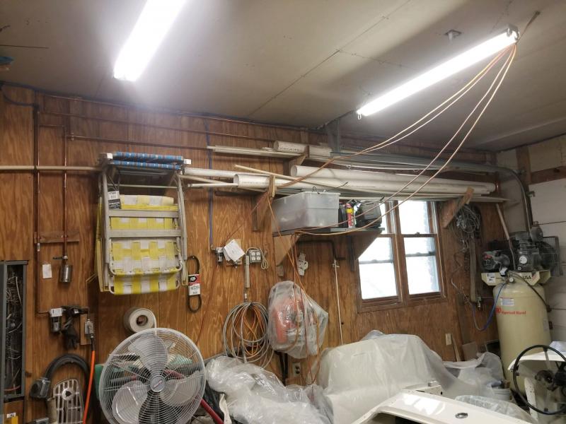

DavidApp
The horizontal lines are slightly angled down towards the drain line. The drain line often collects about half a cup of water after a few hours of sand blasting. More of the setup.
