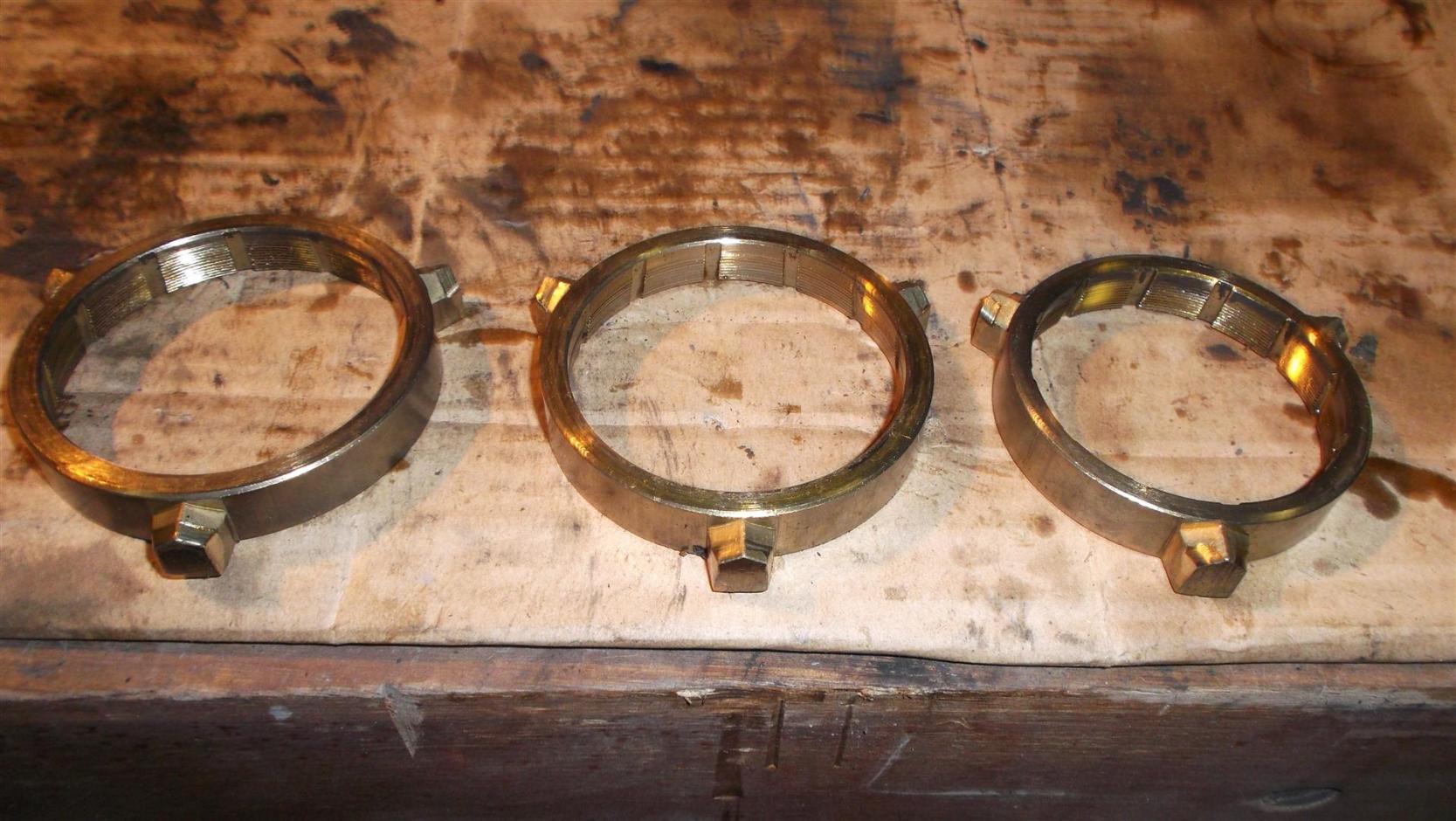

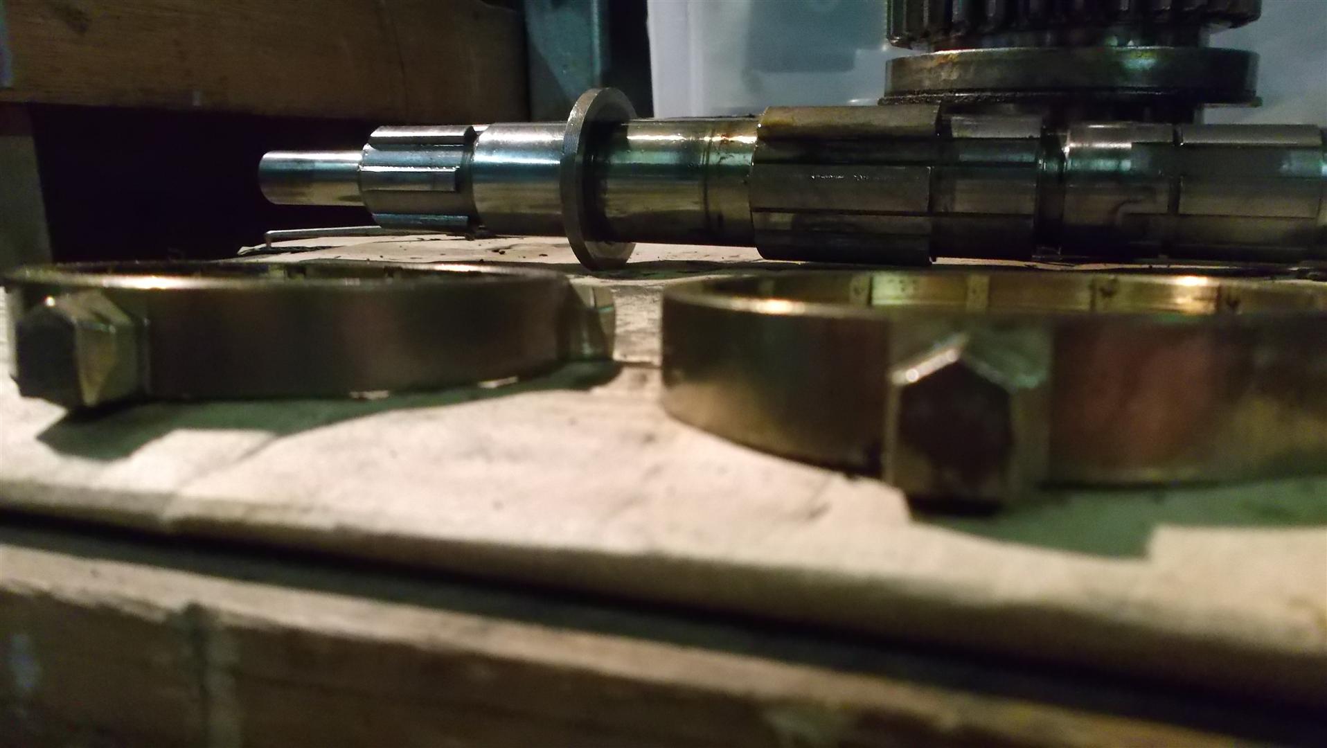

could I have some expert opinions please? I am rebuilding my BN4 gearbox and I'm wondering if I should replace the syncros. I am happy to do it, but from my experience with my MGA I'm wondering if worn original syncros are better than reproductions. The new ones I put in there don't give me a better change than the worn originals and I think replacement parts are often suspect. I've included a picture. I think I could probably keep the third and fourth, perhaps swap them over, but should replace the second. What do you think?

^^Yes. The brief pain your wallet will feel is the comfort of knowing you'll never have to have the gearbox apart again for synchros. Check the archives for a few other BN4 gearbox tips and tricks.
It's the inside of the synchromesh rings that wear the most, and I can see by looking that yours are shot__I don't even need a better view from the underside of your first pic.
I didn't have any trouble with the last few side-shift boxes I've built, so I'd have to say that the Moss ones must've improved (I did have an issue with the clearance on some rings back in the 1980s though). That's not to say the DW rings aren't better, but I have no firsthand experience with them.

Thanks Randy (and everyone)
I think I'll replace them, not a pleasant job to pull it all again. Does anyone have any experience with the AH Spares syncros?

I fitted the uprated synchro ring set from Moss to my BN6. I can't say how they compare to some of the other brands mentioned, but I am very very happy with the gearbox now. I was having a little bit of trouble going into second beforehand (becoming a lot of trouble in the end), where as now it changes so nicely! The rings that came out didn't look as worn as yours either, so personally I wouldn't be putting them back in, but it seems you've come to that conclusion. Anyway, that's my 2 cents.
DerekJ
I fitted AH Spares rings about 12 years and they were fine. If anything, the quality may even have improved since then as they are constantly involved in upgrading their products.
