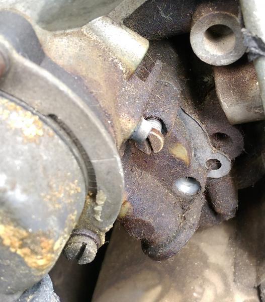

Choke falling off the car.
A reminder to check nuts and bolts and screws when you buy a used MG.
I found two screws laying in the channel under the carb, glad they were still there.

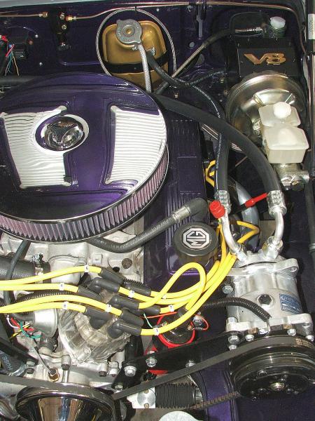

I had a header bolt back out on Cylinder #5 on my V8....gone...as I was replacing it with a new bolt, I happened to look down...the old bolt was lying in the chassis rail. I noticed the bolt missing in Michigan...I was back home in Illinois when I replaced it. Stowaway!

Well the choke doesn't work now but - the car starts fine and drives much better without it.
