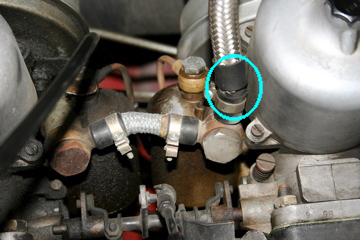

I will check the venting when daylight returns as you suggest. Meanwhile I shot a picture of my float chambers. The little hole I referred to is just south of the true banjo vent and washers in the picture (right side chamber) also just below the philips head screw on the clamp; the hole is surrounded by a nipple of some kind - part of the chamber casting - and looked to me like a dirt collector. I'll ignore it.

Maybe it's just the angle of the photo, but your fuel line looks weird. Like it has a kink in it.

I noticed that too. In a larger picture it looks less kinked and more like the outer black rubber is split in two, part under the clamp and part not. The outer woven sleeve does not look like it goes all the way under the clamped part. May need a new hose? I will look at the real thing in daylight.
