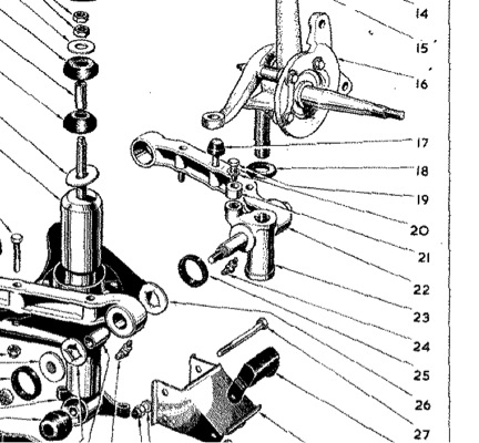

Randall,
What I'm referring to is not the bolt but rather the "lock stop collar", #21 in the attached graphic from the service manual. Moss just refers to it as a STOP. Thanks

Right, #21 on your diagram is the stop, P/N 101407.
The bolt is just an ordinary 5/16NF, 3/4" long, available from any hardware store.

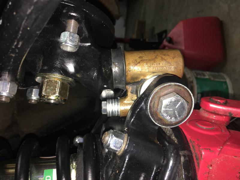

Continuing this thread. No one has actually said if the Lock Stop is really necessary on the tr4A - 6
On my TR3 the vertical links screw right down into the trunnion so they engage the lock stop on the trunnion very close to the bolt head and onto the OEM stop washer (1/4 " thick).
I have just finished rebuilding the front suspension on my 4A and have discovered the links don't screw in as far as on the TR3 with the surface on the link that engages the Lock Stop being a good 3/4"+ (vs 1/4" on the TR3) above the trunnion surface requiring me to stack 7 washers under the bolt head (have no OEM stop washers). This would appear to risk shearing off the bolt. In fact one of the trunnions I had to switched out for this reason (I was not able to use a tap as someone had already tried this and broken the tap in the trunnion).
I am guessing without the stop the tyres might touch the body in full lock, and the trunnion bolts come in touch with the break disk. On the other hand the only time the steering would be in full lock would be at very low speed when parking or when doing a 3 point turn.
Any feedback would be helpful

Thanks Berry,
I was guessing this was the case, but surprised that the links dont screw down as far as on my TR3. On using the Stop Washers from the TR3 on the TR4A the link surface that should engage the stop rides above the stop washer, which is why I have to stack additional flat washers. I have read that they redesigned the links in the TR4A's making them "handed" which they weren't on the TT3A's. This appears to have resulted in other unexpected changes as described above?

Dear confused,
It is not the bolt that is the issue, it is how high above the trunnion the flat surface on the vertical link is in relation to the top of the trunnion. The vertical link screws down into the trunnion, and there is a flat horizontal surface on the link that engages with the stop washer (hopefully you are following along here).
On my TR3A the link screws down into the trunnion to where this flat surface is approx 1/8 - 1/4" inch above the trunnion top so it will engage with the stop washer which is 1/4 thick. On my TR4A both links bottom out with the flat surface riding about 1/2"+ above the trunnion. (note I am screwing it in without any other parts attached which could interfere with the assembly).This results in it riding over the top of the stop. To solve this I have to stack multiple washers in order to raise the height of the stop so that it will engage with the surface on the link. I have had the whole assembly apart cleaned and switched out one link and trunnion. All three of them do the same thing. The rubber seal is not the issue. They say a picture is worth 1000 words so I am attaching two. The dirty assembly is that of the TR3A.
