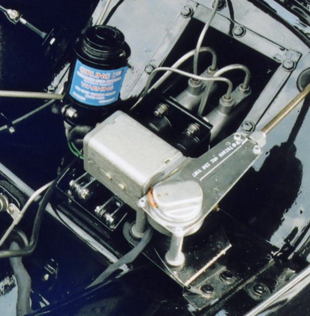

It runs above. For an overdrive it actually mounts on the bulkhead shelf just in front of the battery - there is a p clip that holds it in place. I snapped a picture of an example:
Tinkerman
Tinkerman
Thanks Randy, I looked on my bulkhead and saw no hole in the proper area but then remembered this was a no overdrive car when I bought it, so I'll pop a hole in there and move on.
I noticed that you put your Girling sticker on the battery side of the reservoir can. Most of the ones I see are on the front or W/W side which doesn't match with whats inside. I just rebuilt mine (for the third time, grrrrrrr) so if this fix takes and it doesn't leak I'm going to put the sticker where it most resembles what is inside the can.
Thanks for the picture, Tinkerman

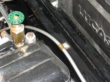

Dick - The original "P" clip that came with my 1958 TR3A new is still there. It is brass with a top and bottom plate. It is held as in the previous photo with a sheetmetal screw with a straight slot.
As for the Girling label, there are arrows or words that indicate which pipe outlet is for the "Clutch" or for the "Brakes" and you sort-of have to line up the decal as per where the pipes are located. It's possible to rotate the reservoir so you can see the decal from any position.

Possibly you are referring to the protruding ends of the steering column support studs. See photo below, which is from plate AN - drawn for a right-hand drive car.
TR4nut
Ah, they were so cleaned up they looked like snaps to me too. The shot is one I took of a local club members car - restored about 10 years ago and close to 100K in cross country miles just like Don Elliot - and still great looking car too.
