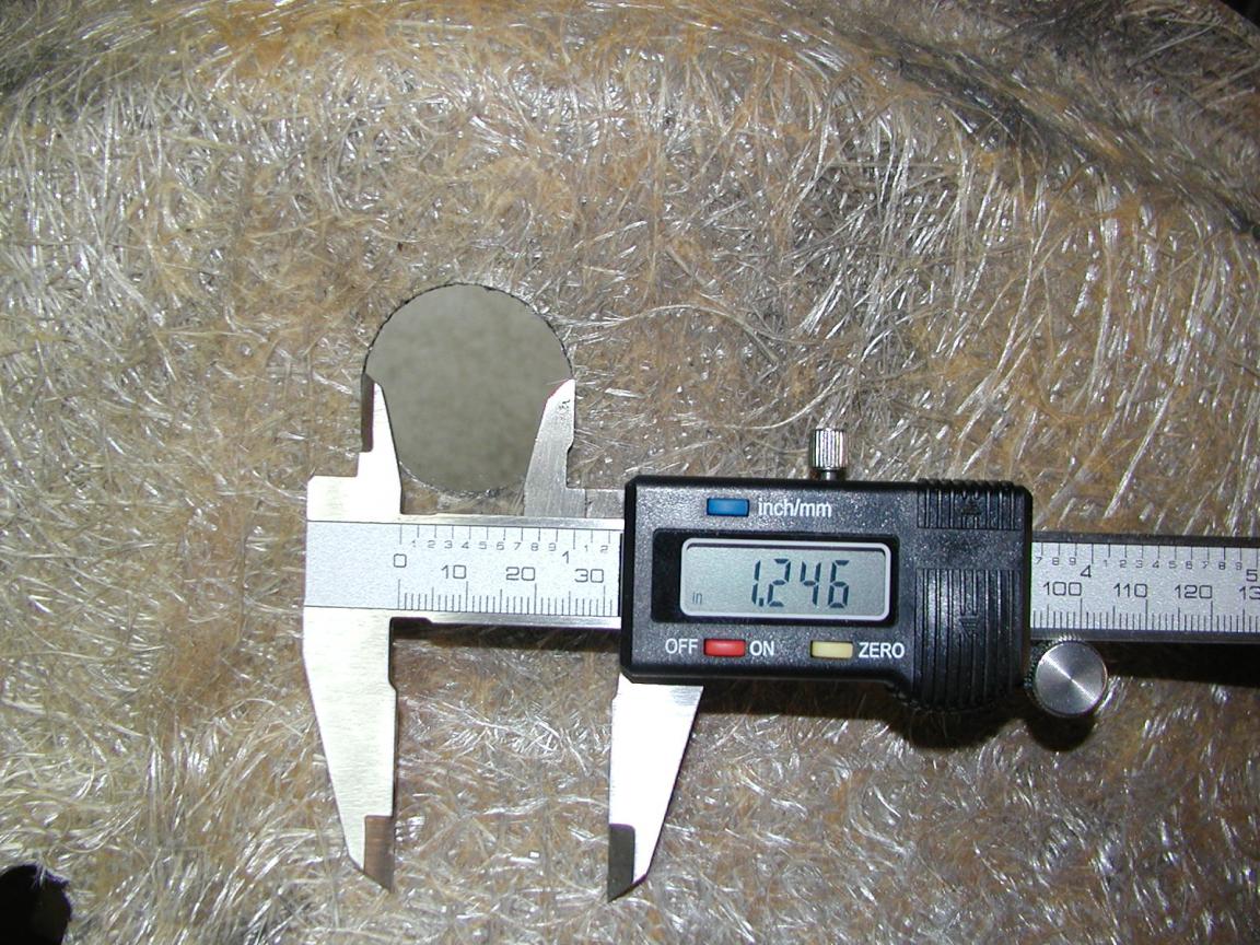

Could any one give me the measurements for the hole in the top of the bj8 gearbox cover for the exit of the speed o cable. thanks Saltiga

Not exactly. The regular grommet is for going into steel and the fibreglass is thicker. I suspect the more uncaring suppliers will give you a grommet for steel which falls right out of fibreglass.

Saltiga,
The speedometer hole in the extra gearbox cover I have looks like this!
