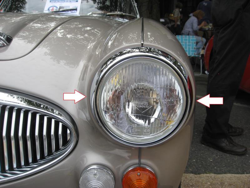

I was hoping to ask for measurements and advice on the sizes of the outer diameter of the headlight bucket recess along the front shroud and fender for a later year car (like a BJ7 or BJ8). As part of my restoration, I need to slightly reform these outer edges on my car, and I would like to get the positioning and size correct.
I have seen cars with recesses set up like the on in this picture, and others where the outer edge of the headlight trim ring is basically just about flush with the outer edge of the recess along the fender and shroud edge.
I truly appreciate any help or advice, thank you.

Anderson & Moment page 163 shows a BJ8

I believe there is different styles/sizes for the rim. Are the rims for the 100 the same profile for the 3000's or are they more rounded like the one shown?

Not sure if there is more that one rim size or not. Mine were ordered right out of the Moss Catalog. P/N 164-080, which seems to fit BN7 thru BJ8. I did not notice anything in the catalog about a different size rim, although this is possible.
Quality and fitment to actual headlight bucket seems good, so I was planning to tailor my fender and shroud to match it. The picture that I included above was taken at car show that I was at this summer. The car pictured appeared to be a fresh professional restoration, and absolutely beautify. Everything on the car looked perfectly correct, and of course it is a BJ8. I have seen other beautifully restored later year cars, with the headlight rim fitted much closer to flush with the outside edge of the fender/shroud. Hence my question. A ruler measurement on the width form the outer fender edge to the outer edge of the shroud would be a great help.
I appreciate any thoughts that you have on it.

Bill, Can you give us a "side view" and a "3/4 view" of the rim that's on your Healey.

Hi Bill
My opinion is that rubber supplied have few mm less than original- when my preparation are at the end this is the gap that appared to me
https://picasaweb.google.com/112770...MayJune2011endMayJune2013#5796995951562000642
But solution for me was easy to do-I have build two simple rig of electrical wire 2,5/3mm diam -connection can be covered by black self restrict sheath
https://picasaweb.google.com/112770...MayJune2011endMayJune2013#5796993826176867506
https://picasaweb.google.com/112770...MayJune2011endMayJune2013#5796995099031777794
https://picasaweb.google.com/112770...MayJune2011endMayJune2013#5797291666550862866
NOT perfect but a lot of the gap disappear when completely finished

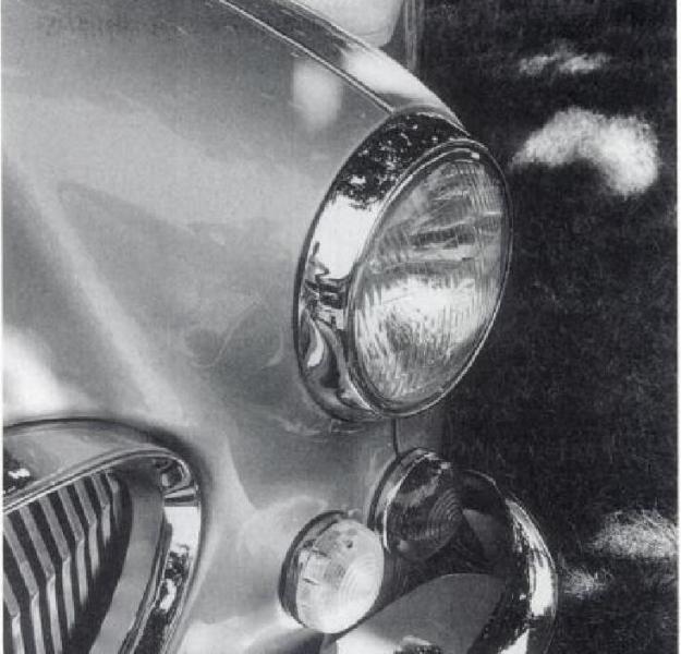

BigGreen
This is a picture from one of the aluminum prototypes
Production started with one of the AHX cars, this is number 11
And from further away
This is a picture from an original Cream coloured car
Two times a 100-6
Three times from 3000, BJ7 and early BJ8
My idea from this is, on BJ7 and BJ8 there should not be more than a very little recess
