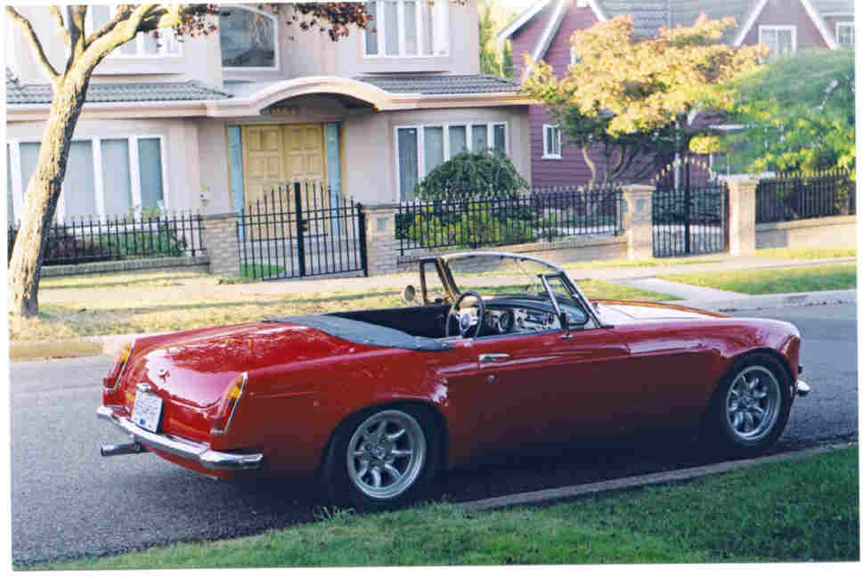

I use 8 inch rear and 7 inch front rims with 225/50x15's all around. Rear is tubbed as well as having flares.

Tubbing was to square up the inner fender. Rear end was dropped a couple of inches so the rounded inners could take a hit on a big bump. Probably not really necessary, but...
If I can figure out how to make a pic the right size I will post one.
dons66
Not sure how well this comes out, but here is a pic.

jlaird
My my my, that is preaty.

dons66
Hard to hit the pumpkin, not without staddling a curb or going offroad. Easy to hit the exhaust system though.
Bruce74B
Hey Don, thanks for the pic...I have been thinking about doing that when I do my repaint and my wife was walking by and saw me drooling, looked (expecting to see porn I suspect) and said "oh, that is nice...you should do that" /ubbthreads/images/graemlins/cowboy.gif
