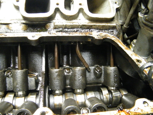

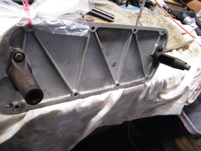

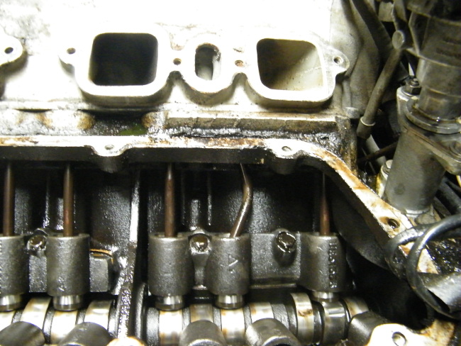

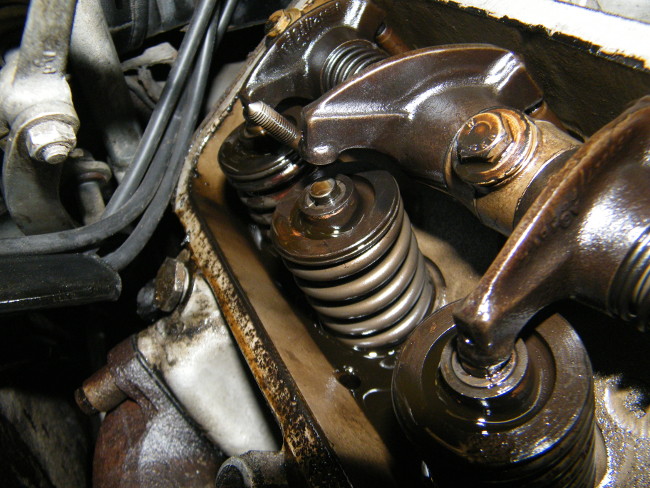

Corniche wouldn't idle, compression in the A4 hole (starboard bank, rear cylinder) varied wildly. Sometimes on first stroke it'd go to 120 then fall off, sometimes nothing. always leaked down quickly. Yesterday the rocker cover came off, the exhaust valve is apparently a bit out of adjustment... :oops:
Not sure if it has a collapsed lifter (a notorious problem) a bent rod, maybe both. The exploration continues.
EDIT: My bad. That's the intake valve for the cylinder.

From the look of the valve tip it has been this way for a looong time.

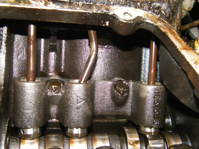

Partner pal just found the "what" for the miss, now must find the "why." Lifter is fine in its bore. We're likely to see the head removed before knowing just what caused the bent push-rod. Seems the valve galling/sticking in the guide would be about the only cause. Owner of the car has to make some decisions...

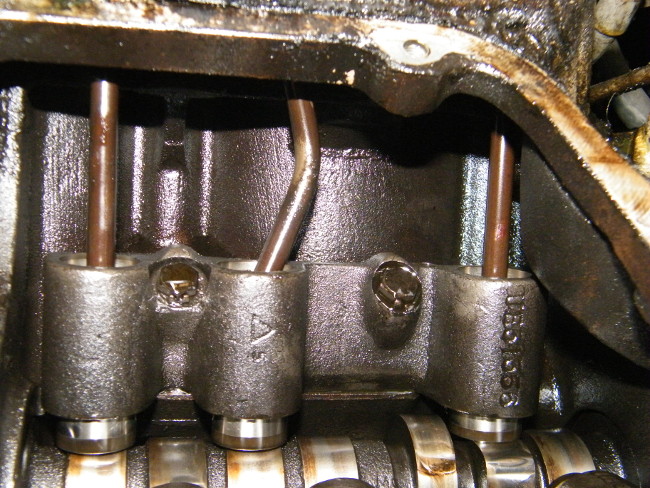

Yowee that mama is BENT!

Valve moves freely in the guide, Marvel oil down intake to cover the valve head and no leaking past it. The mystery cause remains.

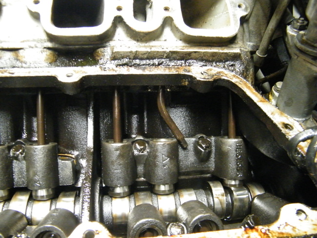

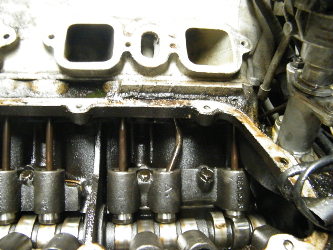

I wonder if the gap at the lifter allowed the rod to jump out of the cup at the bottom - the way it is bent sure looks like it was pushed down on the edge of that cup - there might even be a witness mark.
Platinum
Possible, JP. Tho no witness marks on either end of the rod. Funny thing is, it didn't make any outwardly audible noise or rattle while running, even using a stethoscope. It appears the lifters were "substituted" with something other than Rolls ones at some point, they don't have the right oil galley holes. There was a Chrysler lifter that fit, a Rolls Owners Club bulletin was warning against their use, that was decades ago. But we're uncertain what this set is just yet. Time will tell. The biopsy goes on. :unsure:

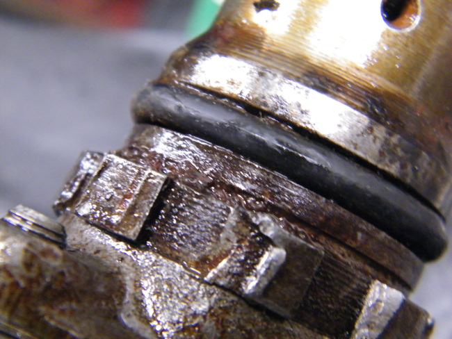

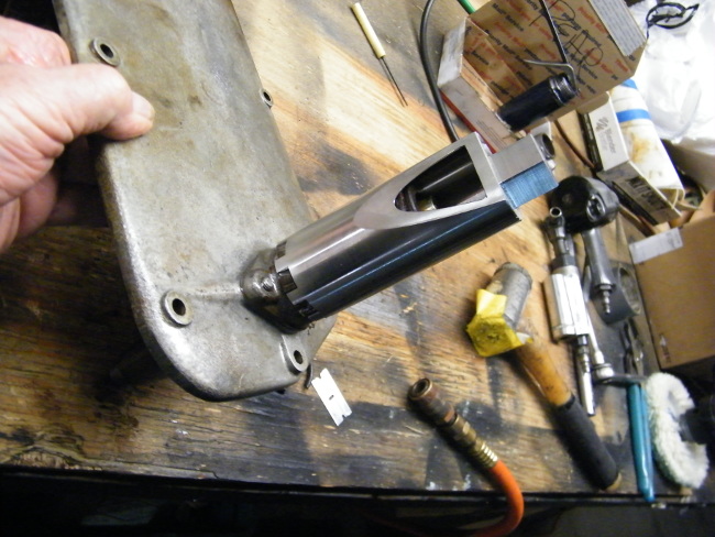

Heads are off, going to machine shop. Hydraulic pumps are two different types, one original, both really crudded up with goo to the point it was difficult to get them apart. On top of that, the replacement one had apparently had its castellated nut tightened with a CHISEL(!). Took time to file the chisel-displaced material smooth enough to use the tool to remove the ring nut. It was so tight and corroded the tool was the only way to undo it. Pumps and accumulators are cleaned up and instead of rebuilding here, they'repacked up and going for exchange. That saves hours of fussing.

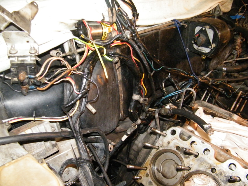

Now for the sorting of the loom! A LOT of impromptu "free expression" with regard to the wiring over the decades, apparently. A genuine nightmare.
Told partner: "Cut the BLUE wire!!!" :LOL:
