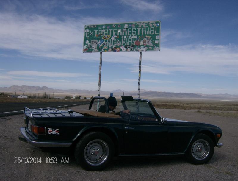

Madflyer
HPIM2684.jpg As for all good of the above commits' see my head also less view at rear view mirror . This Bar was not SCCA cert. as it only attached to floor panels and back deck not frame. Soft top still had room. I never added a padding and have since removed Bar It did make the car easy to push around. Madflyer
