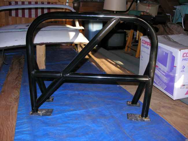

Personally, I prefer the four legs to be on two different planes: the main hoops on the rear floor behind the seats, then anchored underneath. And the support legs bolted through the rear shelf and then supported to the frame.
The main hoop of the bar in our 3A is anchored on the sloped rear floor and reinforced underneath with 4x4" 1/8" plates. The legs mount to the rear inner wheel wells and also through 4x4" 1/8" plates above the rear tires.
The bars that anchor all four legs on the parcel shelf (like tdskip posted) just don't seem to provide strength unless the legs are continued undeeneath to the chassis. Also there is no diagonal bracing of the main hoop to prevent it from folding.
I sold this one on ebay a few years ago when I changed my mind on the design. It's nicely braced, even has a harness bar but I didn't like the hoop and legs sitting together on the shelf.
