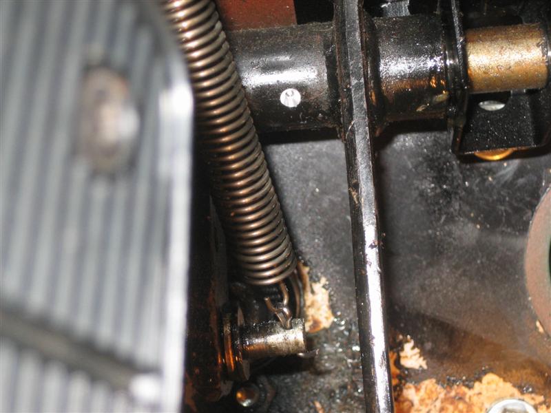

View attachment 28419Here's a picture of mine apart, and as Randall says, there is more to remove than just the bolts at the end. -The lower 'cover' (bolts tach-welded in place) must be removed. The two bolts into the cross shaft were really difficult to get out, even after it was off the car.

It looks quite similar to the TR4A pedals. While you have it out, good time to clean up the shaft and lubricate. At one point my pedals both moved together.

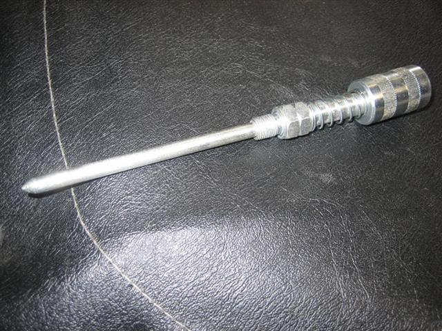

I used a center-drill to make a tapered hole. Now I can use the pictured adapter to lube my pedal shaft. But like the old commercial, "a little dab will do ya"
