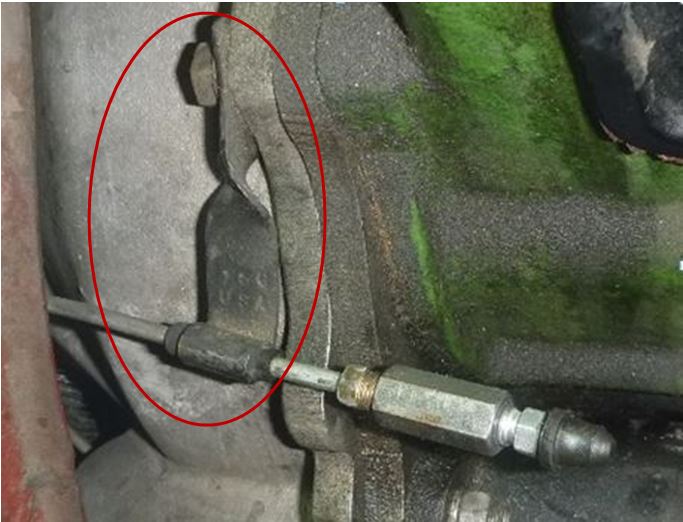

I was looking for a clutch remote bleed kit and don't see any sold for a BJ8 anymore. So, I decided to make one instead.
The only part that eludes me is the bell housing line bracket that was used on most commercial kits. Is this available anywhere?

Thanks John. I thought about that. Not sure I can wrap a 1/8-inch X 3/4-inch piece of iron neatly around a drill bit and insert a rubber sleeve as shown in the picture.
The parts shown must be available because they have USA and a part number stamped on them. Unfortunately, I can't read the part number from the pictures.

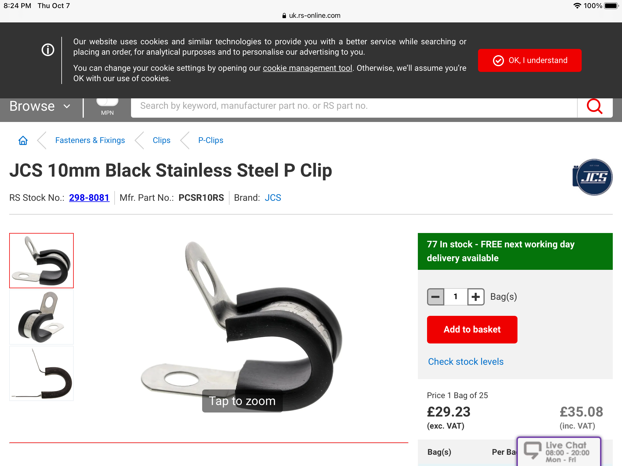

Instead of routing the extension tube up why not route it downward and use one of those stainless P clips withe the rubber cushioning in them and use the lower bolt on the bellhousing to secure it.
no brackets Needed just one or two P clips available from any good nut n bolt store . I know you can get them at Canadian Tire in Canada in packs of three I think .

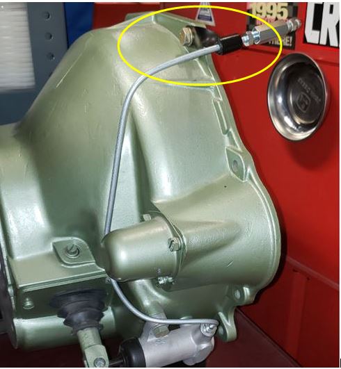

Bob Haskell made up a few sets last year, but I heard they are all gone now. Bob used the same bracket used in the originals (I believe) as seen in the second picture I posted. I just found his information and wanted to credit his picture. The first picture was from Steveg.
I took the transmission tunnel off this morning to take measurements and look at routing the bleeder line into the engine compartment. I think the SS flex line is probably the best way to go regardless, just to minimize any problems with engine and road vibration.
Someone in an archived post mentioned he could work the stock bleeder valve from underneath to bleed the slave cylinder. They must have long, thin and multiply jointed fingers like ET.
Lastly, if someone reads this thread years fron now, you can easily gravity bleed the slave cylinder with the transmission tunnel lifted a few inches. I only post this because when searching the archives, more than one person said you could not gravity bleed the clutch slave cylinder. It worked well and a few taps to the slave cylinder with a small rubber mallet release air bubbles. Like the brakes, we now have a good, firm clutch pedal.

BTW, the bracket is 3/4" wide 14 gauge, not 1/8". I made a jig to roll the end that the steel line goes through since I was making more than one. The steel line is held in the bracket with a 3/4" long piece of rubber fuel line. The twist in the middle can be done with a vise and a adjustable wrench - pad the sharp corners so you don't ding the bracket.
