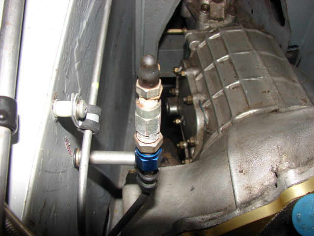

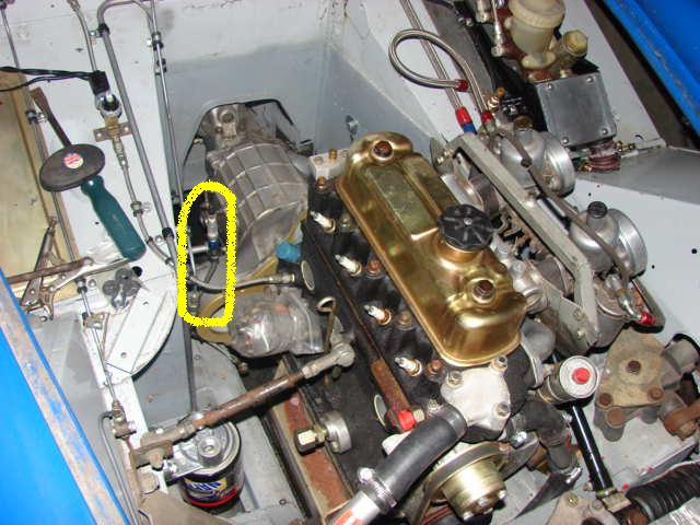

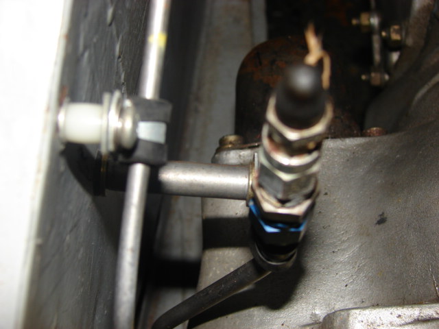

Willie, some quick snapshots.
Jeff

Jack, if I recall, I used either a #4 AN union at the slave, or a #3 to #4 reducer. Use a copper crush washer for the seal there. I can't remember if the slave bleed fitting on this one was 3/8" x 24 or 7/16" x 20 thread. Obviously, use whichever size is appropriate. The line is standard 1/4" brake tubing, with a #4 AN sleeve and "B" nut on each end. The bleed screw setup I'm pretty sure I bought from Summit. You don't have to use a bleed screw, as I've seen it done with merely a plug in place of the bleed fitting.
As to the routing, that can be done anyway you see fit, but make sure to support the line to avoid vibration and breakage. You can see the standoff and Adel clamp that I used for that part.
It sure makes bleeding the clutch a snap.
