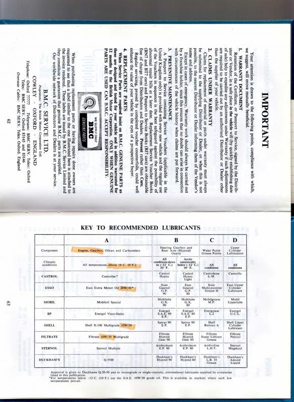

vette
I stand corrected Bob. Can't dispute the written word. For years I have been using the Driver's Handbook to reference quick facts. It does not specify 20/50 but only shows viscosities up to 20/30w. It is curious that where 20/50 is specified in the Bentley manual that only certain manufacturers do so.
Here is the page from the Driver's Handbook:

vette
tried to make that page bigger:
My hunch is multi-vis oils were just becoming widely used in the 60s and 70s; as more multi-vis brands became available they were arbitrarily added to the 'recommendations.' I doubt much if any suitability/compatibility testing was done and, who knows, there may have been some 'backroom,' er, discussions between the auto manufacturers and the oil companies about what brands should be recommended. Some current owners use a 20(?)W-60 multi-vis; I'm comfortable using Valvoline 20W-50 (my engine builder OK'd it).
