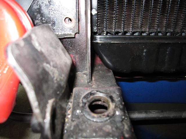

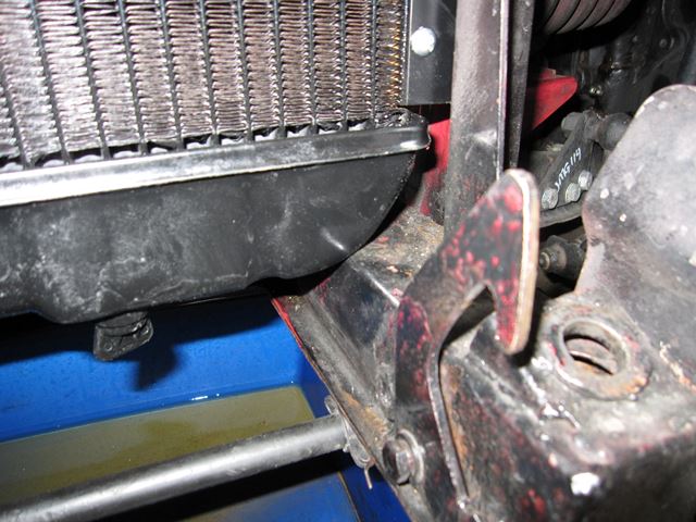

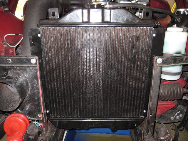

I bought a brand new Geo Metro radiator to install in my BE. Like all the posts have mentioned, I made sure to get one meant for a Geo with an automatic transmission. I even paid extra to get an all metal construction with two rows. I fabricated some nice aluminum mounts (one on either side of the radiator), set it as low as it would go in the BE (see photos), but it turns out to be too tall by about 3/4" and the bonnet won't close! There's plenty of room between it and the water pump, so since the bonnet slopes up, my next idea is to use some rather large spacers to move it closer to the engine. If that doesn't work, then I guess I'll put it on eBay and buy one of those Chinese made aluminum radiators! Anyone have any experience with the Geo Metro radiator in a BE and can tell me what I'm doing wrong?
Follow up: 'Tried moving the radiator back as close to the water pump as it would go (thinking I could put the electric fan on the front as a pusher). No luck - the bonnet still won't close. :-(
'Wish I knew how people have been able to put this radiator in a BE!
Dan

That very well may be the difference. I didn't pull a used radiator from a Geo parts car, but I just assumed that a new one made for that car would be the same. 'Live and learn. :-(
That may entirily be true. What about just tilting the top toward the engine a'la Corvette?
I think I'd have to also pull the bottom forward too. Apparently this radiator is really just too tall. I'm going to call the vendor on Monday and see if they'll refund my money since it's never had water in it.

Be advised that some of the aluminum ones are built to fit both manual and automatic, i.e. "universal fit" which makes them too tall to fit our application. Before purchasing any Metro radiators, insure you get a total height measurement, not just the core measurement.
Don't ask me how I know.:sorrow:

As a last resort, how about having a rad shop notch out the two lower tank corners? PJ

The installation by Frank Clarci is on SpriteSpot.com under the cooling section. Topic is modern smaller radiator for your A series Spridget. I noticed he was using a Speedwell bonnet which looked like it was hinged from front. He also mentioned getting it straight out of a junkyard. I have put this one in a 73 midget. The bottom of your radiator looked like it mounted the same distance from the bottom rails. My radiator measures about 17-17 1/2" high including the cap. Some also mentioned having a problem getting it to mount in a bugeye. I think I also got mine from Genesis. It is a close fit even in the Midget.
