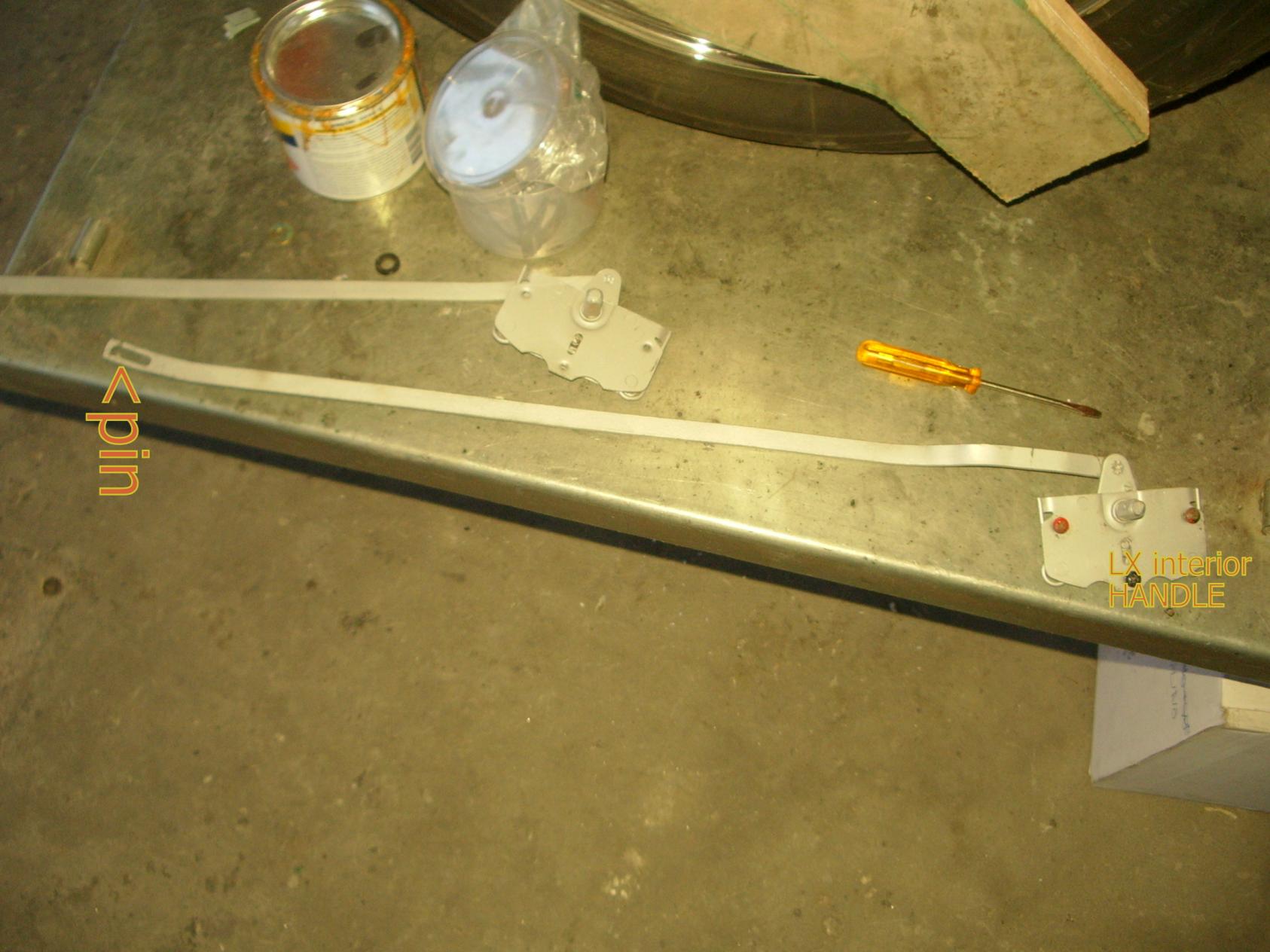

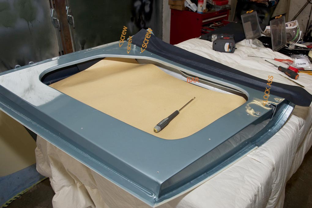

Hi John
Normally is sufficient a little bent of the command bar DSC4918a.jpgIMGP1970a.jpg

Thanks for the input. Yes I did a bend too and it helped, but still not enough. Took the striker plate off and of course no shims. Made of small modification to the post and now it works.
