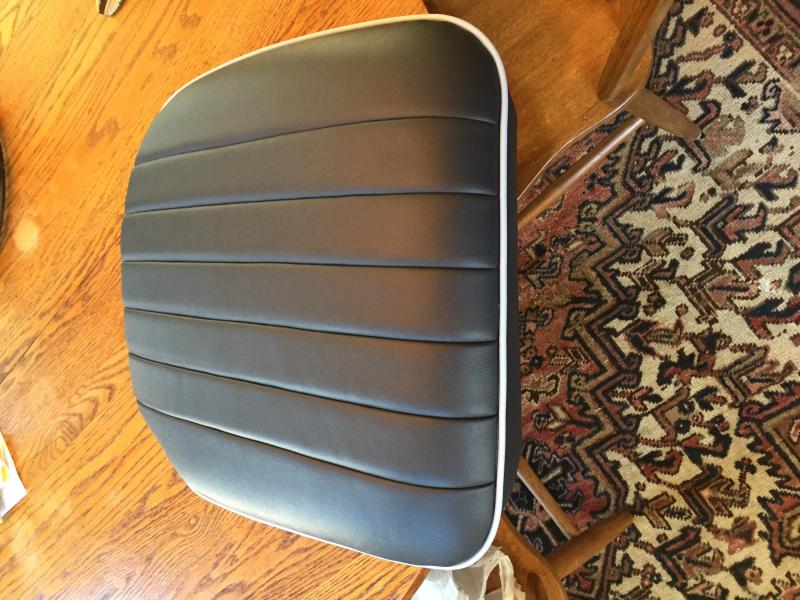

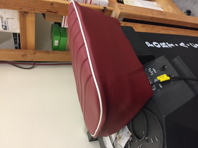

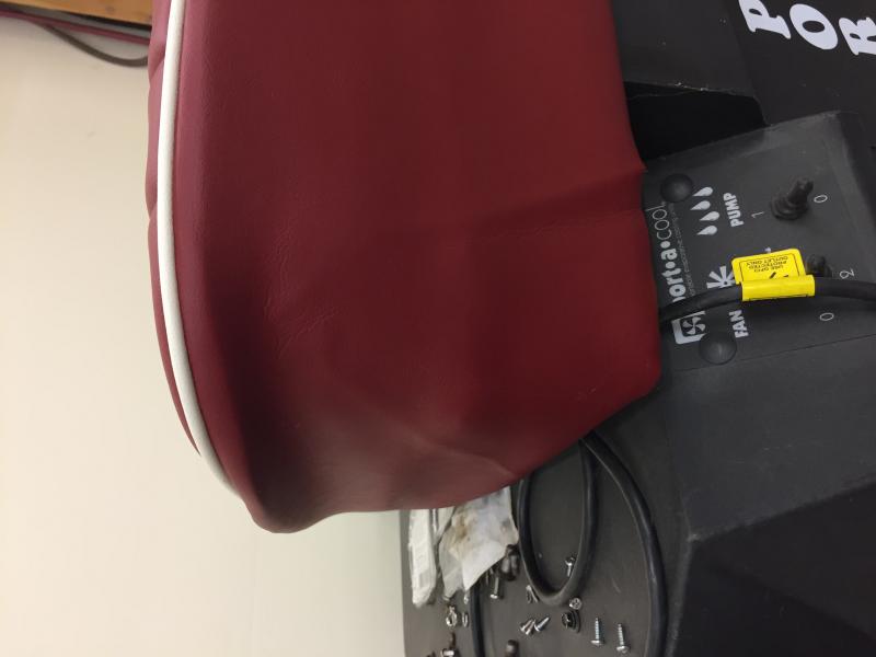

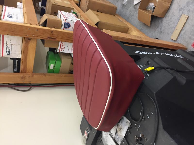

I'm installing the seat covers I purchased about 2 years ago from AH Spares.
I bought the seat cushions/squabs and covers as a set.
The bottom cushion seems two small relative to the seat cover.
Is this something that others have run into?

I bought my seat covers and innards from AHSpares as well and mine fit much better out of the box. You can always go to a car upholstery supply shop and get additional foam strips to fill in the shallow areas.
Good luck, Rut

Fred,
Mine are the way they came from AHSpares, but I’ve had to add material to my TR4a seats to fill them out. I just spray a little adhesive on the foam to keep it in place and add batting to smooth it out. I’ve seen 1/4” thick foam used as well to keep seams from showing thru.

Like to mention that the replacement seat foams are no where near what was originally fitted. If it is still and option try to resurrect the original foams at any cost. I've used other old foams to cut strips from to glue onto worn areas. An electric carving knife shapes the foam quite well and good old contact cement seems to be holding well many years later.

It does seem like the seat foams may be the culprit in the poor fit. My old seats were from a 64 Sprite and while nice seats, they are different than Bugeye seats, as most here know. So I only used the metal portion of the seats, which are the same. New foams, squabs, and covers. The seat base foams look smaller and more contoured than I imagine the originals were. Perhaps the replacement seat covers are good fits to the original seat foams. Seems like they could reproduce the foams accurately without that much trouble...

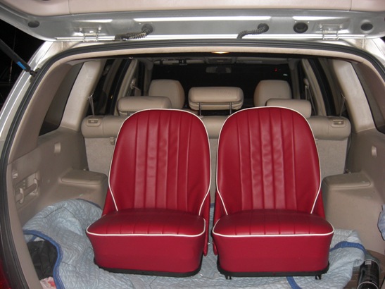

I bought AH Spares seats years ago and added additional foam to fill out the lower parts of the seats. CIMG1682a.JPG
