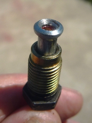

Reporting back on the Eastwood tools mentioned above...
NFI.
Summary: The inexpensive, very well-made Eastwood tool takes the guesswork out of 3/16" double flares. It will also straighten the tube end enough to get a good perpendicular cut with a decent tube cutter.
The more expensive Ridgid 345 is more versatile in that you can also make bubble flares and the 1/4" supply lines from the tanks to the master cylinders.
IMO the deburring tool is a nice-to-have, but the lines can be deburred with a countersink on the inside and a file on the outside. The straightening pliers will help you make nicer-looking runs.
