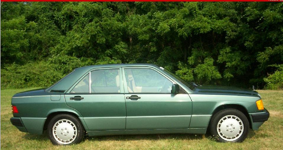

Bought it locally; found on craigslist. Came with new brakes and tires and a pair of mounted Blizzaks for snowtires. $1900 and change.
High miles and it needs a thorough cleaning. The owner had meticulous maintenance records for the last 10 years or so. Oil changes, transmission filters, diff fluid changes, brake fluid changes. A/C converted to R134a and blows cold. A couple of door dings, but absolutely no rust anywhere. It spent much of its life in Charlotte, NC.
When I got it, the tach and the power windows were in-op. A new fuse fixed that. Drove it a couple hundred miles and something broke in the throttle. I'm hoping it's either a cable or a linkage clip. I think Doc has some experiencing wrenching on these, so I'll PM him.
It's built like a tank and the doors still close with a solid thud. Parts are still available and about on par with an MGB for common stuff (rotors, pads, wheel bearings, shocks, etc).
All in all, I'm really happy with it.

They're not bad little cars. As in all Benzes, the fluids need periodic changing(sounds like that's been done) then the rubber goes next(suspension, mounts, etc...) good idea to keep a bottle of silicone spray and spray all accessible seals every couple of months(door seals, etc.) the accelerator is usually the plastic end linkage ball clip..
But metal is usually good forever... Not a bad deal from your description.

Thanks Ron. Ball clip popped out of the throttle linkage. I McGuyvered it back in place with a couple of zipties. Ordered a new cable and a pair of spare clips.
This thing must have 10,000 vacuum hoses; they seem to control everything. A couple of the elbows look suspect, so I ordered a few of them as well.
