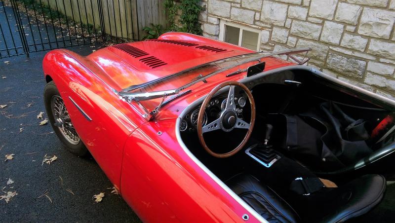

Hey Cat, Here's one my BJ7. I don't know much about the different hubs and this was on my car when I bought it so I just continue to use it. But it is flat. Also I think the steering wheel position on my Healey is better that positions such as an MGB.

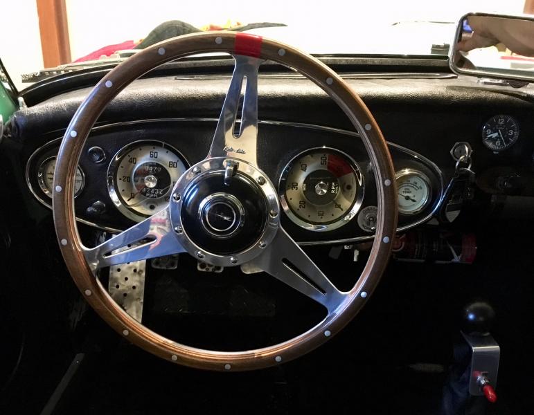

I have a flat adjustable hub and Moto-Lita wheel on my '57 100-6 MM. No trouble mounting it.

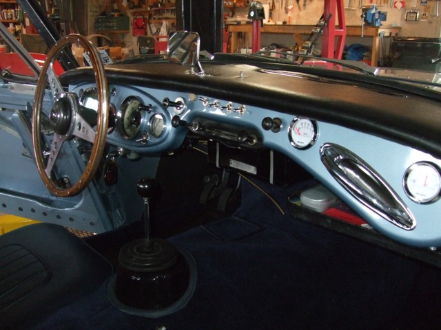

The Moto Lita wheel on mine__non-adjustable column__has a pretty shallow dish to it. It's not so much that it makes the wheel feel appreciably closer, but does give a little more knuckle room around the crash roll.
Or maybe after forty (>39) years, I'm just used to it.
