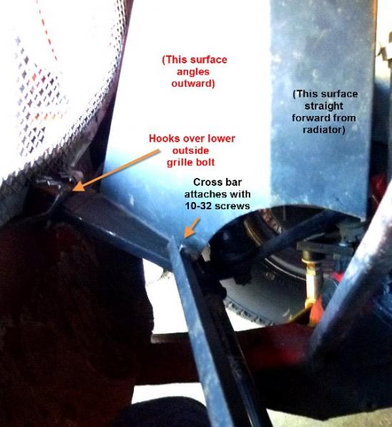

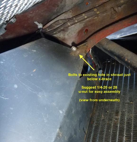

Need Photos? Re: Moss OEM AIR DEFLECTOR ASSEMBLY Does it do anything?
I have a new deflector and have done searches on how it fits but cannot find a good picture. Can anyone with a BJ8 provide some photos as to how this thing installs. I have read it is a nightmare.
Thanks
jjs64bj8
steveg
Re: Need Photos? Re: Moss OEM AIR DEFLECTOR ASSEMBLY Does it do anything?
These are the Kilmartin baffles - Moss should be same/similar:
AirBaffleSideAnnotatedFromBelow.jpg Looking up from below.
AirBaffleSideAnnotated2.jpg Looking from side, behind grille.
J
jjs64bj8
Thanks steveg
I do have the Kilmartin from British Car Specialists. I think I got it. Issue is I do not have the shrouds or any body work on as of yet. Thus it looked like it was just going to hang there with the bottom part at a crazy angle.
Thanks
jjs64bj8
steveg
Yes it would hang at a crazy angle. My picture says "shroud" at top, but it's actually the "cross brace upper panel", item #7 on the Moss page for "Inner Body Panels, 100-6, 3000".
The grille mounting bolts come off the shroud itself.
