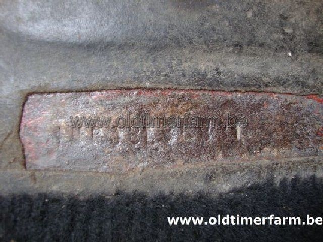

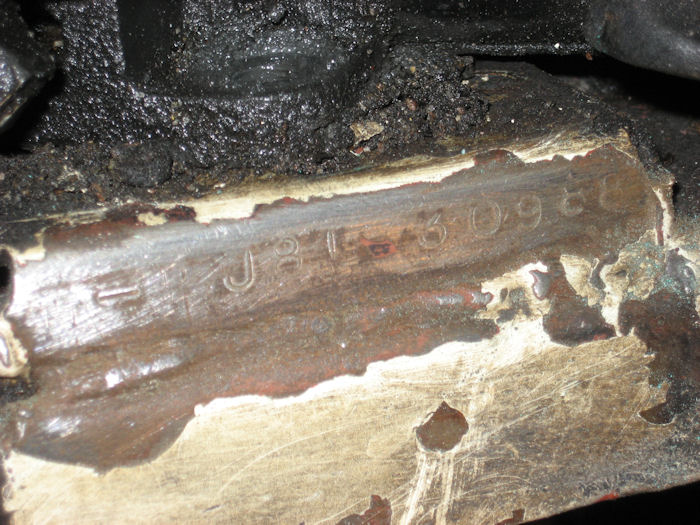

Actually, the Concours Guidelines should say "In theory.....the VIN was stamped..... [typically, the entire VIN was stamped, not just the chassis number].
I've had occasion to inspect a whole bunch of BJ8 shock towers for this number, and in more cases than not, there is no visible/legible number on the shock tower. My BJ8 is chassis 36666, and what I found on the shock tower (only after stripping the paint to bare metal and scrutinizing with a strong light and magnifying glass) was only the bottom curve of each digit. It could have been 00000....
For such a critical number, BMC (or maybe it was Jensen Motors, who built the chassis) was surprisingly casual about how they stamped it.

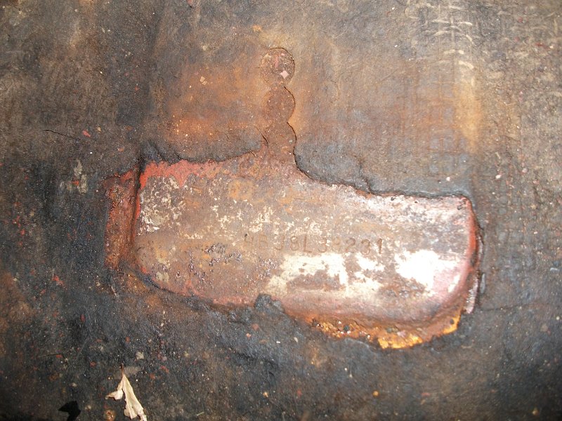

Some few BJ8s have also been found with the VIN or chassis number stamped into the passenger's floor, just in front of the seat.
I do not know if any of that has any relevance to a BT7.
