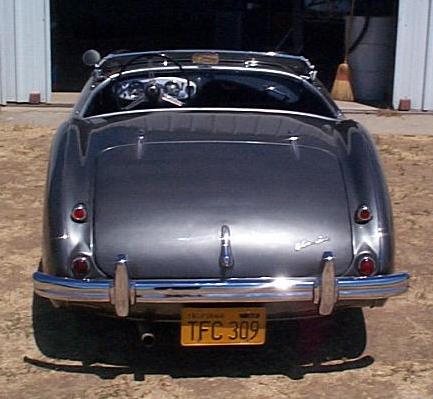

I have a question on the location of the rear license plate for a "65 BJ8. Should the plate be located under the rear bumper? Also should the lic plate light be mounted on the inner bumper?
My plate and light is mounted on the rear bumper like on the picture of "the last Healey" rolling off the line in '67.
Thanks,
Bob
This is BJ8L 41778, a 1967 model.

I believe so. Don't recall seeing it documented anywhere, but early photos show them above the bumper. They're certainly more visible there.
Phase 1 had the plate under the bumper and light mounted on the inside of the bumper. I THINK Phase 2 got the bumper mounted plate. The number seems high for a 65. Is there a "year plate" on the fire wall?

The position of the rear license plate and light depends on the body number of the car. At BJ8 body number 79900, the license plate and light were moved from under the bumper to the bumper itself. Body 79900 is approximately chassis 35000 (HBJ8L/35000). Since body numbers did not track chassis numbers in strict numerical sequence, it's possible for lower VINs to have the later configuration, and vice versa. Also, some owners prefer one or the other and have changed the mounting position themselves.
It's never a good idea to try to determine what is correct for a particular "year" of a Healey, since the registration years are all over the place.

They were predominantly located there when the cars were exported to the US.
This plate frame and location is unique to the US and could have been installed by a dealer or a previous owner of the car.
However IMOP,This later location is the safest location for the plate and insures that you do not inadvertently bend the rear shroud when backing up--Fwiw--Keoke
