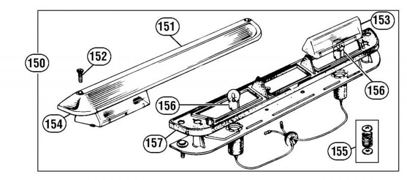

Kevin - is the lamp unit this one:
If there's power going to the entire frame of the unit, then you need to trace what wire is supplying the voltage to it. Wire supplying current should only be connected to the bottom of each "cylinder socket".
The ground for the bulbs is the entire lamp unit, which is bolted onto the frame of the car. Some guys add a separate wire to the unit, to provide a more stable ground. If there's an extra ground wire, maybe it's somehow connected to a voltage source. That's not good.
