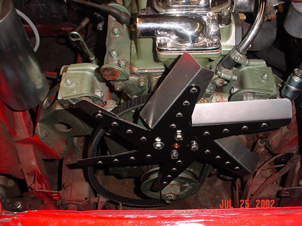

A very good move. A few of the original 4 blade cast ali props have been known to throw a blade. Ali is subject to fatigue failures after a too long service life. There is a photo of where one blade exited through the bonnet. I have a pretty red one hanging on the wall if the car ever "has" to have complete originality.
The six blade fan is also very quiet due to the staggered blade arrangement. See attached pic:
