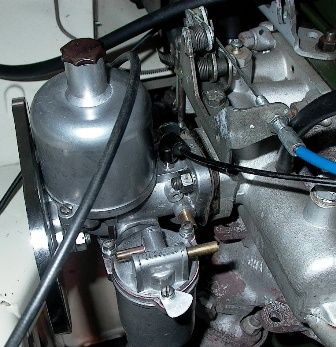

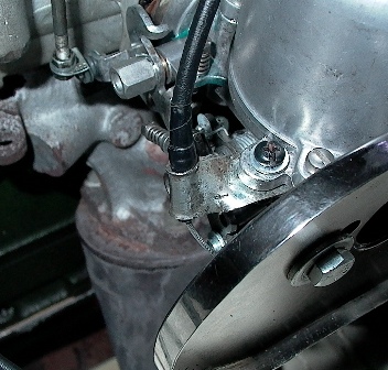

This is my set up for an HIF6.
It's on a "1275". The intake is a MiniMania deal.
Not exactly the same but pretty close.
Hope it helps.

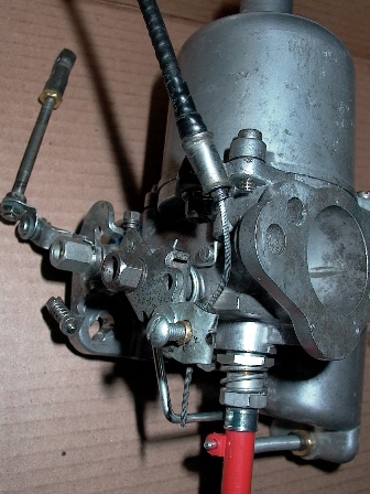

You motivated me to get mine back on. Here is carb with linkage attached

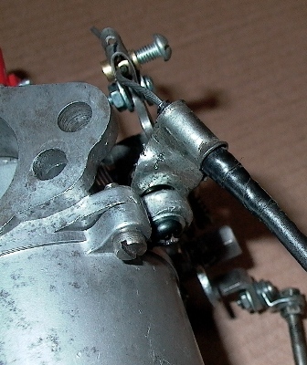

JPSmit
and now with choke cable attached. I McGyvered the clip attaching it to the carb

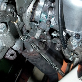

JPSmit
and now with spring

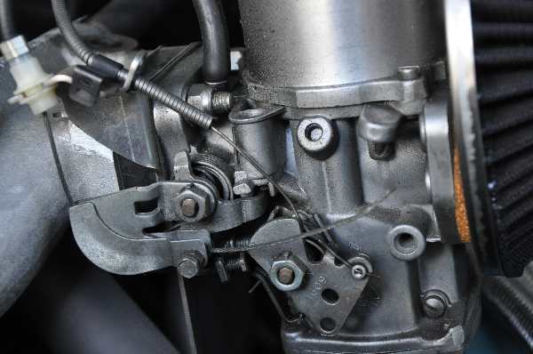

JPSmit
all done
