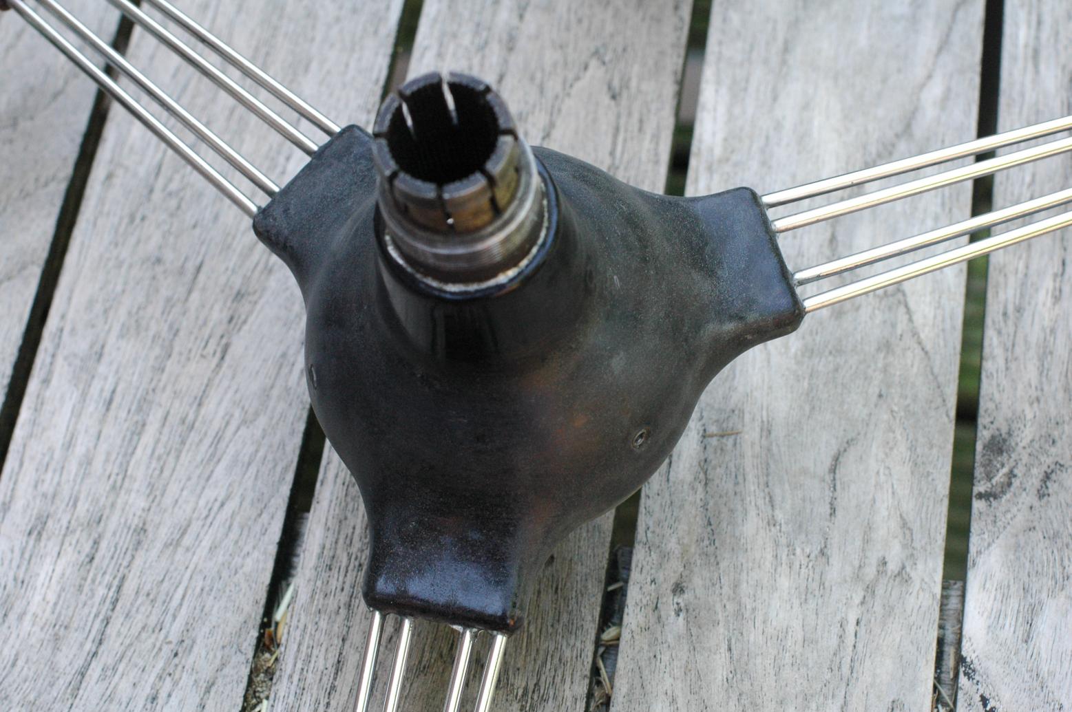

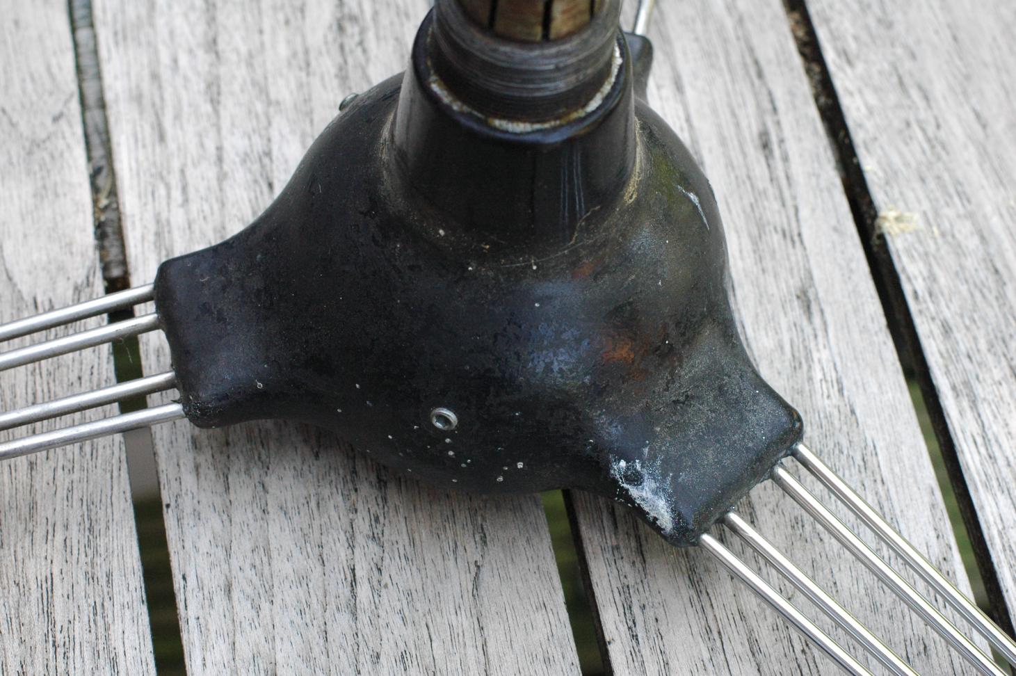

I have two original steering wheels. One is very bad and the hub had something like black paint on it
I sanded the hub and used a mild polish for carpaint.
The word is that the hub is bakelite, but mine is pitted ...
Polish enters these little holes, so you need a degreaser
Wax will enter the holes also, a sealent will be easier
Not used the machine yet, maybe I will go for the shoepolish

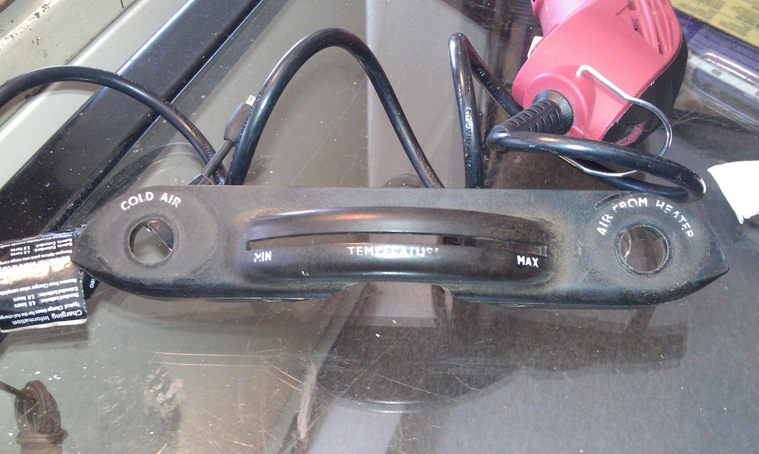

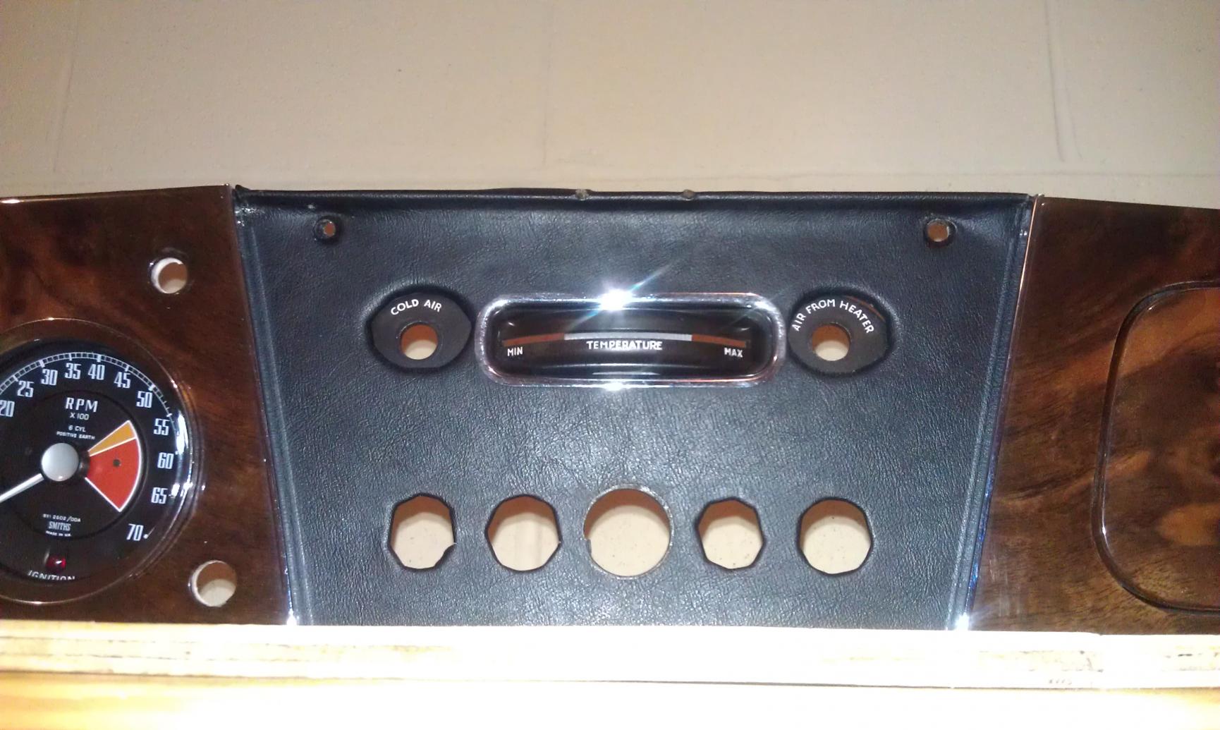

Austin Healey Dash Center Temp. Control 2.jpgAustin Healey Dash Center Temp. Control 1.jpg
Obviously, this is not the wheel hub but the other major bakelite piece which I restored by first rubbing with a very fine compound, then wax (of course, being careful not to rub away any of the letters which in my case were damaged to start with so I restored the letters by hand afterwards).
When I do my wheel, I intend to use an orbiter and very fine compound with wax on that too, especially around the wheel's hub at the spokes. Any advice on that?
