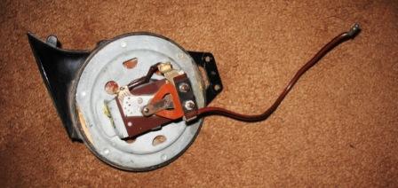

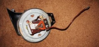

Can someone help me understand if my new wiring harness is missing a short piece of wire? Actually, it would be 2 pieces - one for each horn.
I know the wiring diagram shows 2 wires that go to the horn - brown/green and brown/black. Yet, with my new harness, only the brown/green will reach - see the pic below.
This is the TRF harness with cloth braid - p/n 303004/LAC.
Am I supposed to order a piece of brown/black 8" long wire with the correct bullet ends and a joiner? But there is no p/n or listing anywhere for such a piece. Something seems odd. Does anyone have a pic?

That is the way it was originally assembled. The join between the stub wire to the horn and the main harness uses a 4-way sleeve on the driver's side, with a 3rd wire to the control head.

Thanks guys, but I'm still confused. Does this mean I need 2 additinal short pieces of wire?
And, my pic is the passenger side - so unlike the drivers side, it doesn't use a 4 way sleeve, corect?

Yes, you need the two short pieces of wire. Sorry, I can't seem to find a part number for them.
The passenger side only needs a 2-way sleeve.
CJD
Well, It's actually just one short. The long wire you show goes inside the horn cover to a connector on the internal phenolic plate. There should be another wire soldered inside the horn that comes out and goes into the connector shown in the photo above.
Have you opened the cover on your horn to see if the missing wire is coiled up inside?

Thanks John - neither horn has any wire inside. So, I do need 2 right - one for each horn?

Look inside your horn to see what you need. Mine has a connector for the harness wire inside the horn, and the (missing) other is soldered to the horn on one end and has one of those "torpedo" shaped connectors on the other to go back to the harness. You may need one with connectors on both ends for your jumper.
If you still have your old harness, you may be able to find enough usable wire to make them yourself. I had to do that with several wires and/or connectors that were not supplied with the new harness assembly. The torpedo connectors can be unsoldered and resoldered as needed.

On mine both wires inside the horn had bullet connectors and (as Randall noted) went to a 2-way sleeve on the p/s and a 4-way sleeve on the d/s.
If you need a length of Brown/Black wire to make up those 2 short bits let me know.

The brown/black wire measures 8" long and is secured inside the horns as shown. This is the one from the RH side of my early 1958 TR3A.

Good pic Thanks Don - Is the horn wire soldered or is it a bullet connection?

Mine were originally bullets inside the horn; but the DCO crimped and soldered them instead.
