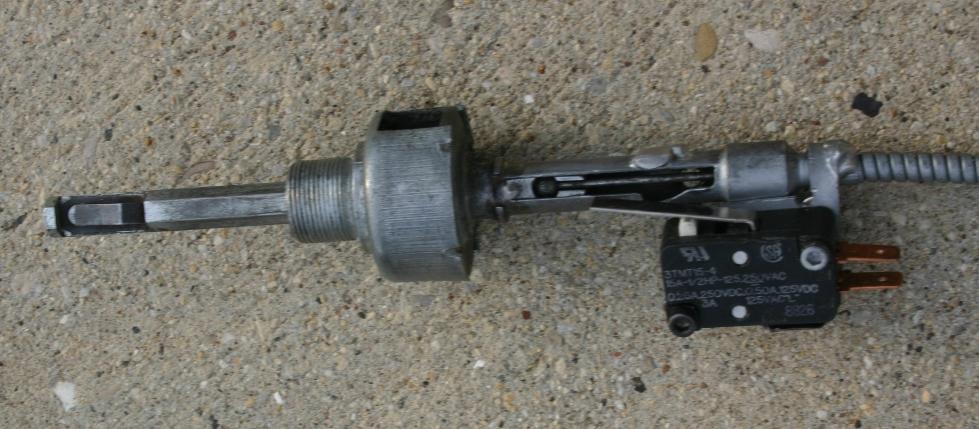

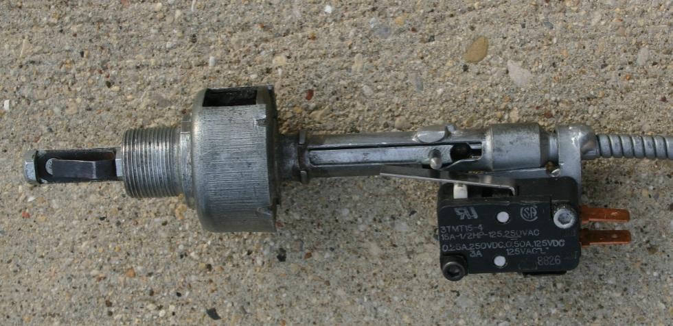

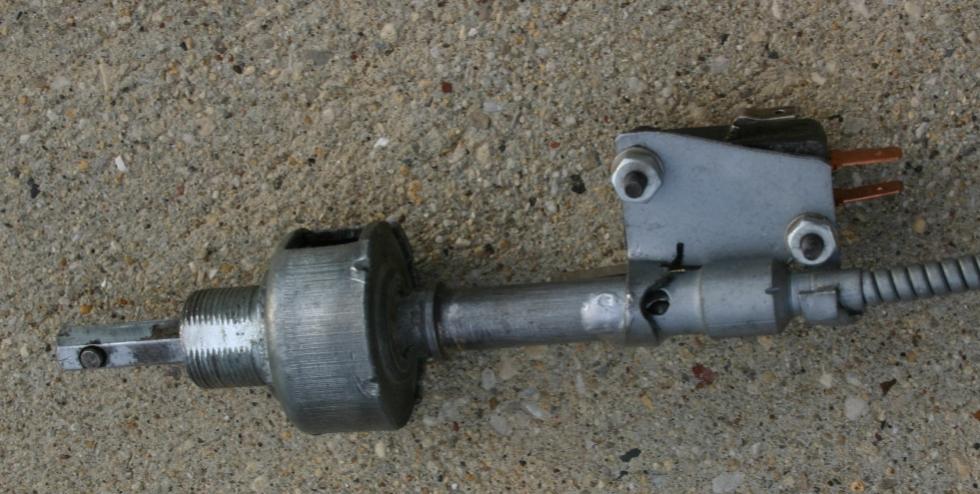

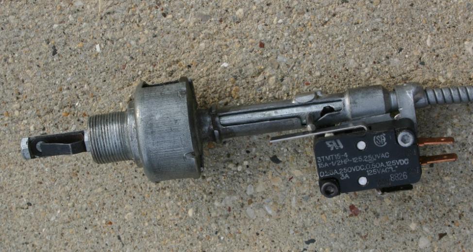

Pictures of modified heater control.
If the left/right twist detent still works, it is not absolutely necessary to take the switch apart. The little pin needs to be extended to actuate the micro switch lever. Extend the pin with a piece of brass tube soldered or epoxied on. For my switch I replaced the pin with a longer one. Fabricate a simple bracket to hold the micro switch in the right place. Mine was a rectangle with extended legs that wrapped around the housing.
Pictures show 1) cable forward = air on, fan switch off; 2) cable forward, fan switch on; 3) back side; and 4) cable pulled back = air off.

Very clever, very, very clever:encouragement:. Now to see if I can find a switch. E-Mail inquiries are out to the UK. Did a Mk II/Midget Mk I use a similiar type switch for Heater Fan control.
nomad
jjscott: Agree that that is a very clean and neat modification!! Thanks for the pic's!
