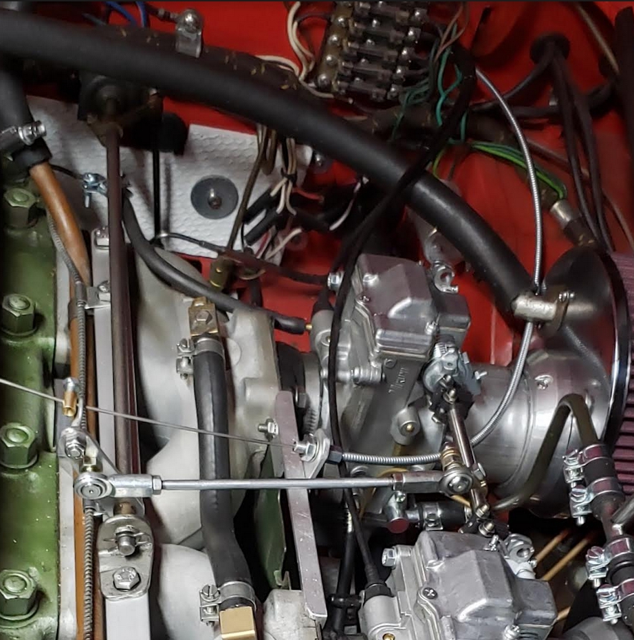

Anyone doing this? I'm in the process of installing HSR 45s on my Healey. Quite a few Triumph owners use Mikunis.
'In the process?' Looks like they're ready to run to me!
What's the advantages to these? Hard to tell function from form, are they constant or variable choke? Is this a kit? Did the offset air cleaners come with them?
Jerry
Tried them on my mini. Too much gas at lower rpm. but at high rpm, sounded like a Harley taking off!
steveg
steveg
Properly tuned, they should provide near-Weber power with better-than-SU mileage. Accelerator pumps provide livelier pickup.
All these claims have yet to be verified by me - will report back as I learn more. Car runs OK with as-delivered carbs, but some tuning is required. Extensive tuning information available online. Requires reconfiguring distributor for manifold vacuum.
It's a kit from > Vintage Performance Developments - Performance products for vintage street and track cars <
Tons of info on that site.
Kit was just over $1100.
Because my DMD manifold uses horizontal carbs, I had to do a number of mods which aren't necessary with a stock manifold.
V-performance sent me this pic of a Healey undergoing installation - Plenty of room for K&Ns without my extensions. The rings shown on mine attach to the carb venturi with set screws:

Nice clean set-up. Me like. Is this fast idle cable operated separately from choke for cold start ups? When would fast idle be used?
steveg
steveg
The Mikunis have only a mixture-enrichment device - similar to Weber DCOEs. Rather than running the mixture enrichment until the engine's warmed up, as soon as it starts, I pull out the hand throttle to 1500 rpm or so, then push in the mixture enrichment. Trying to keep extra fuel off the cylinder walls. So yes, it's separate from the mixture enrichment.
It's like a motorcycle - you enrich it to start, then once started hold a little more throttle until it's ready to go. Since these carbs were originally made to replace SUs on Harleys, that's probably how they do it.
