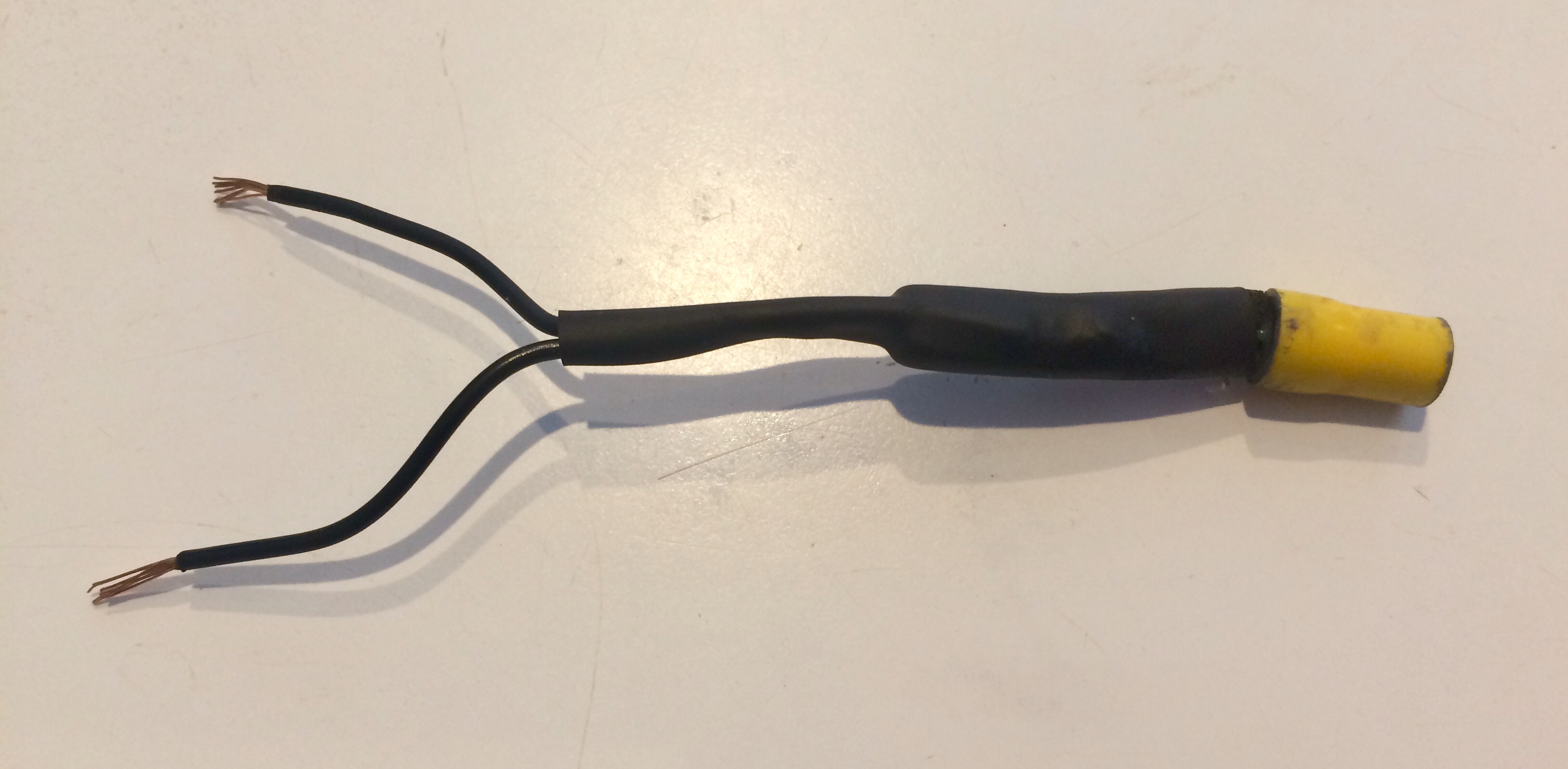

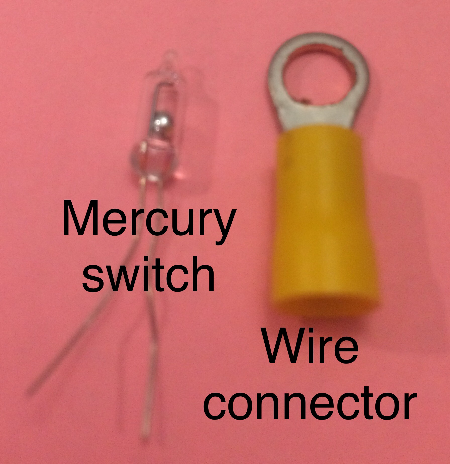

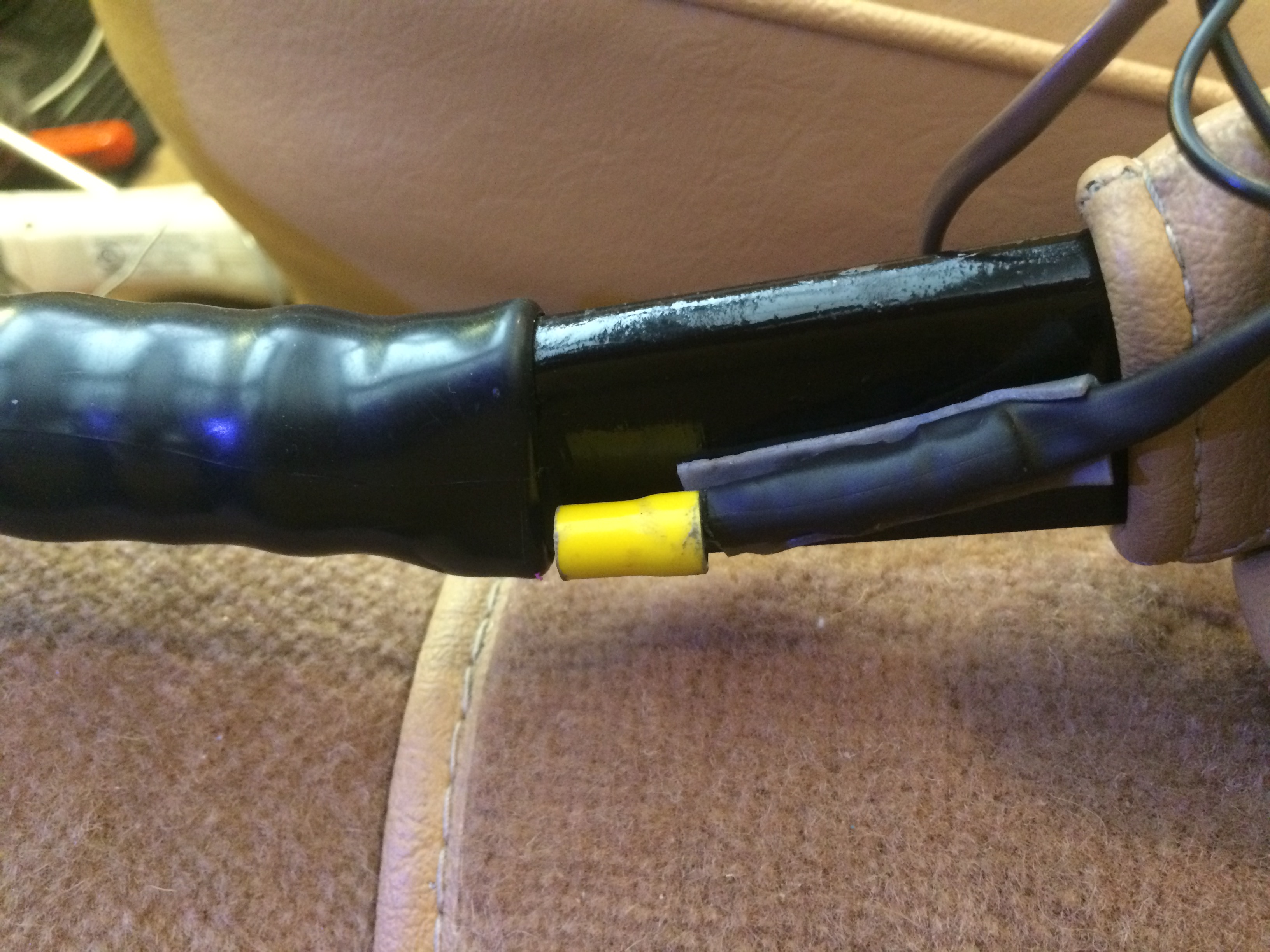

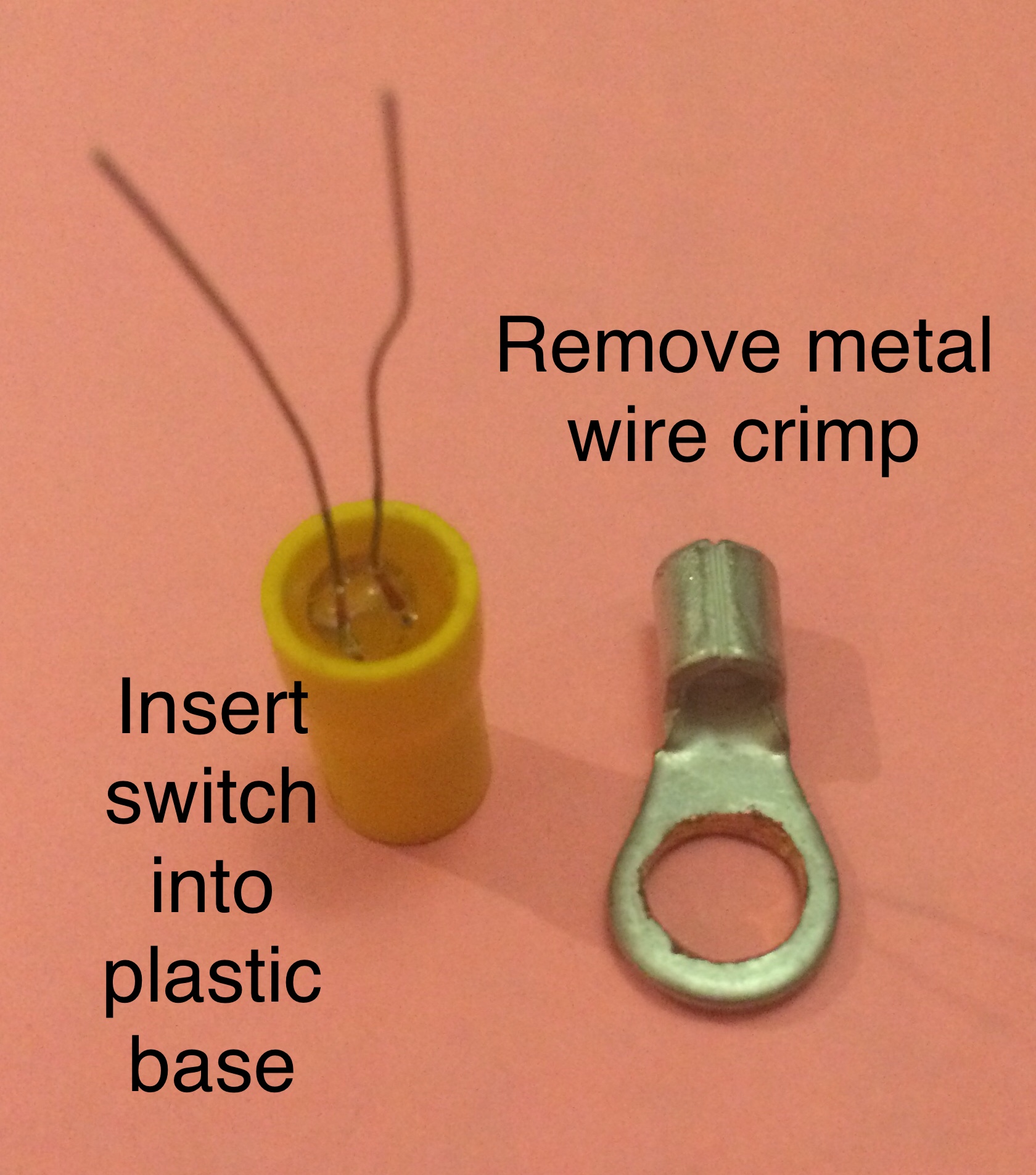

Started with a mercury switch and a wire connector
I used the plastic body from the wire crimp and inserted the glass bulb into it.

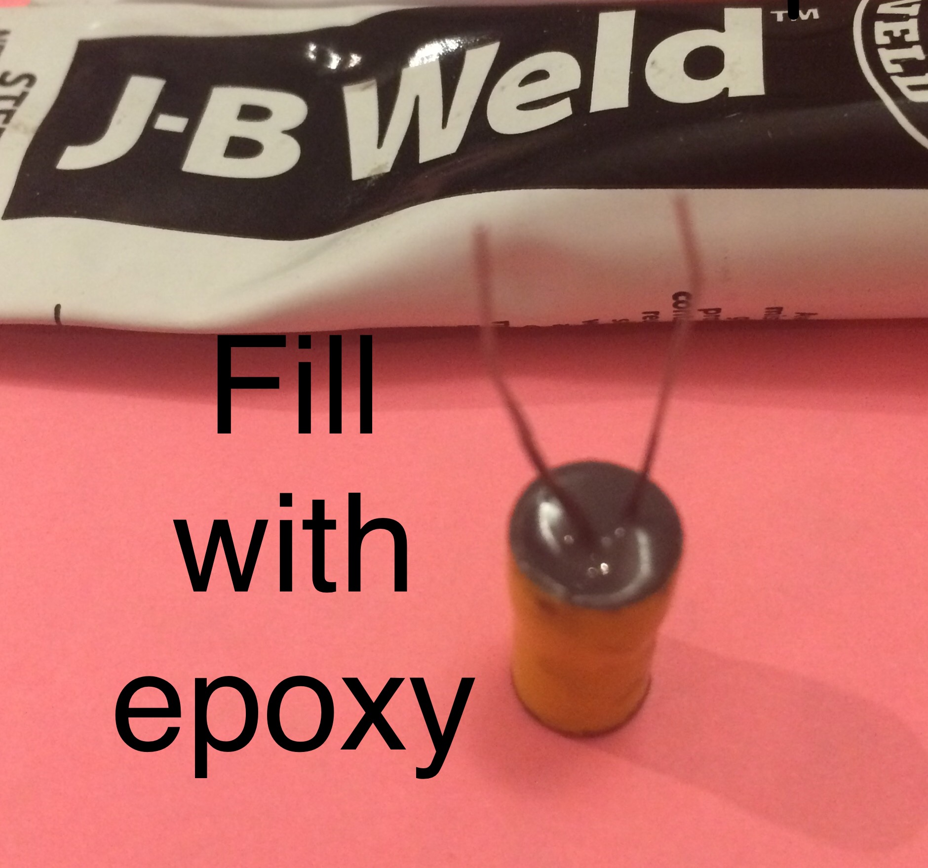

Then filled the plastic body with epoxy.
Attach wire leads and heat shrink
ran a wire to the ground of the brake lamp

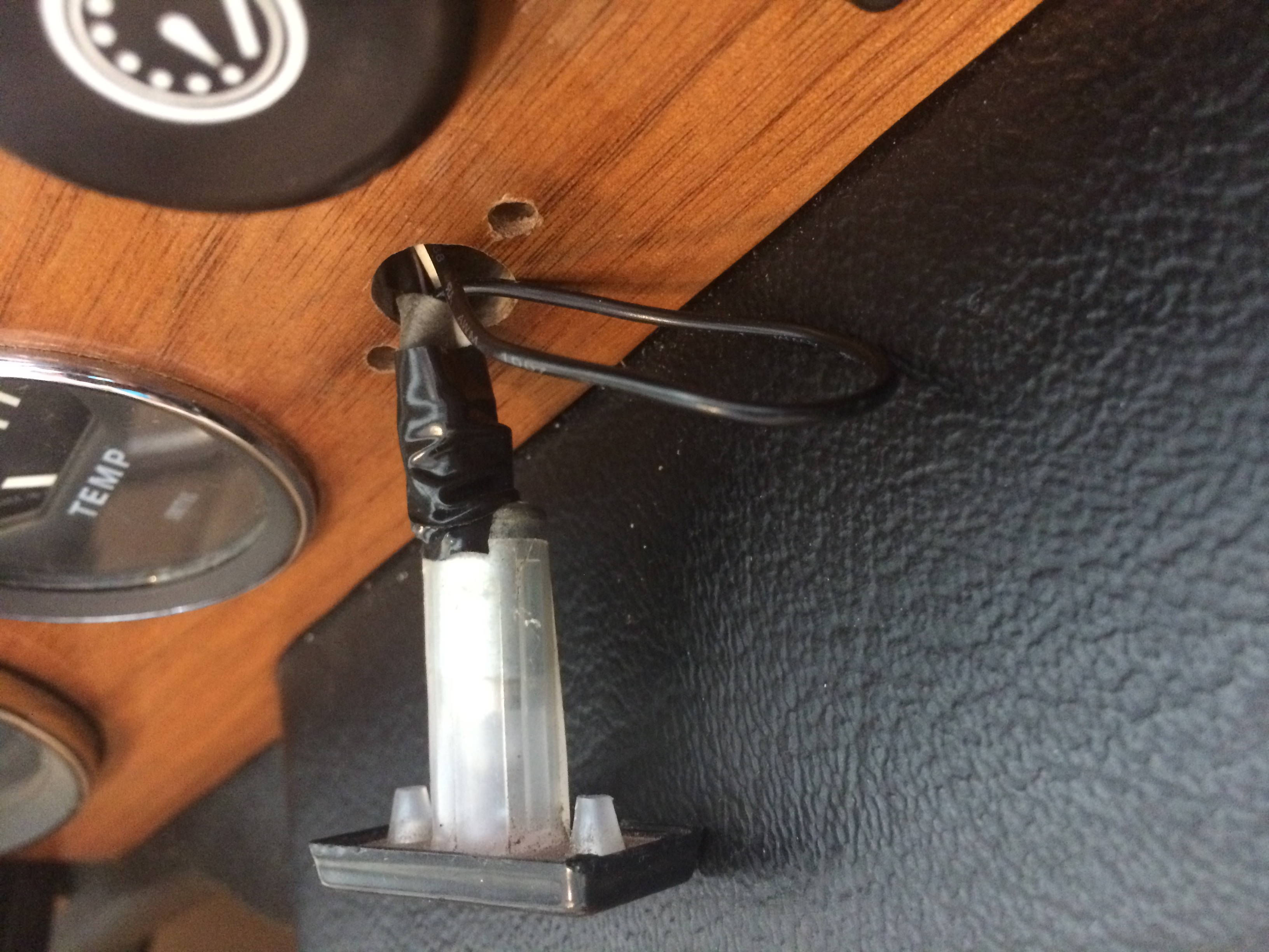

I mounted the switch temporarily with foam tape so I can reposition it to find the correct angle to keep it from flickering on during acceleration. (Note: you do not see the switch, I pulled back the leather handbrake boot to take the pic)

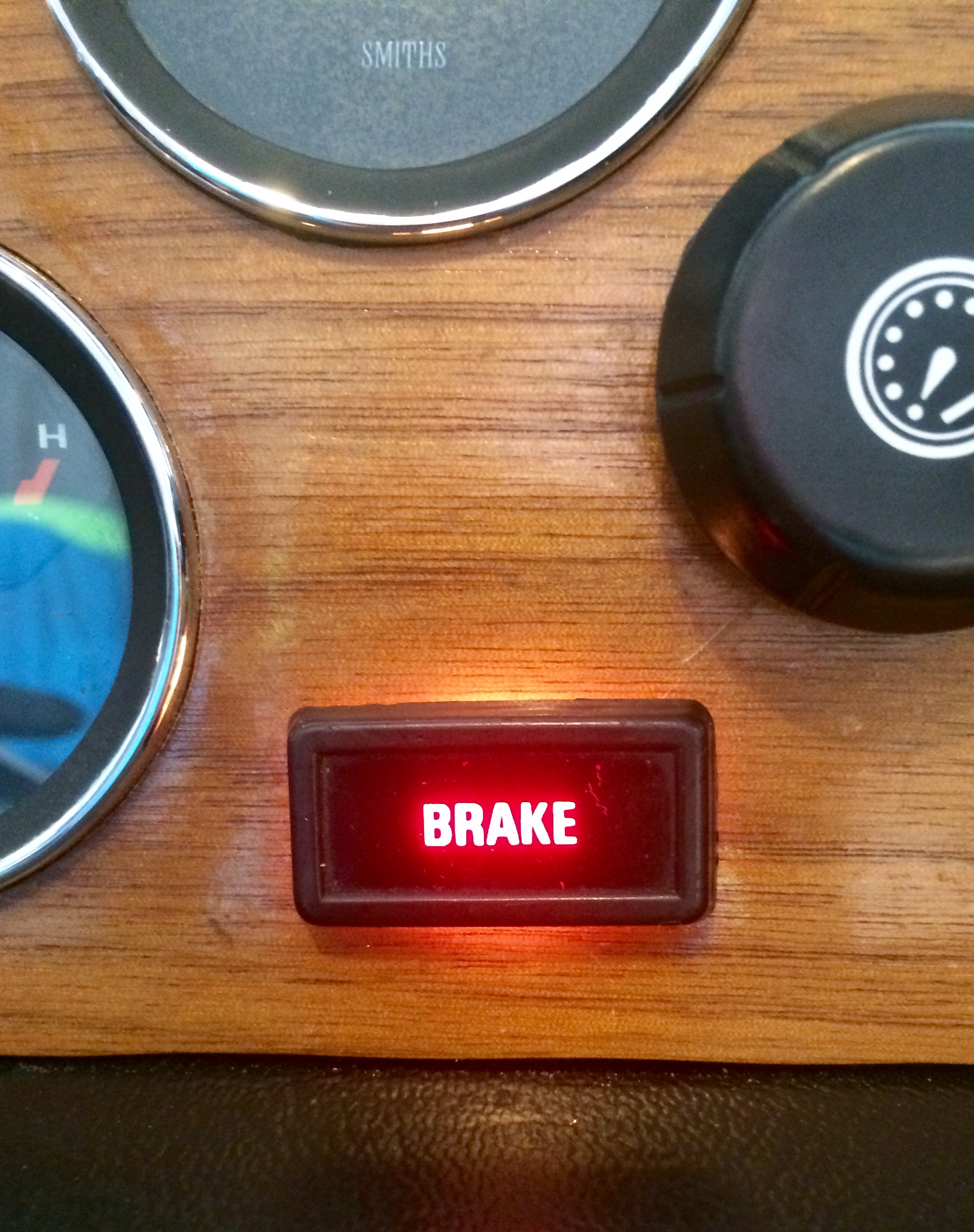

Lamp illuminated when handbrake is raised

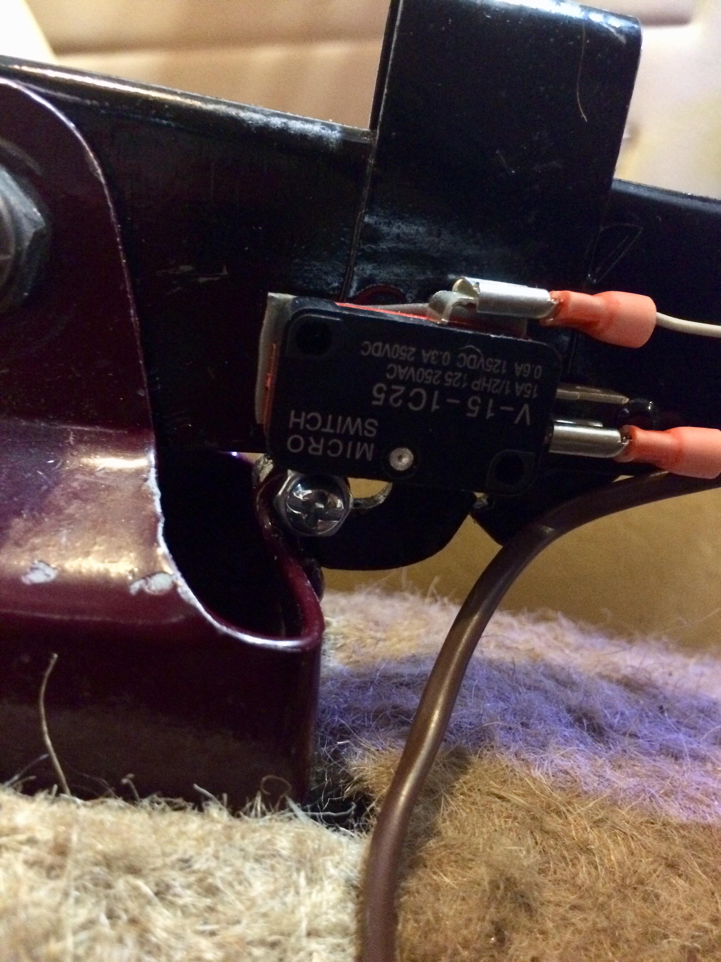

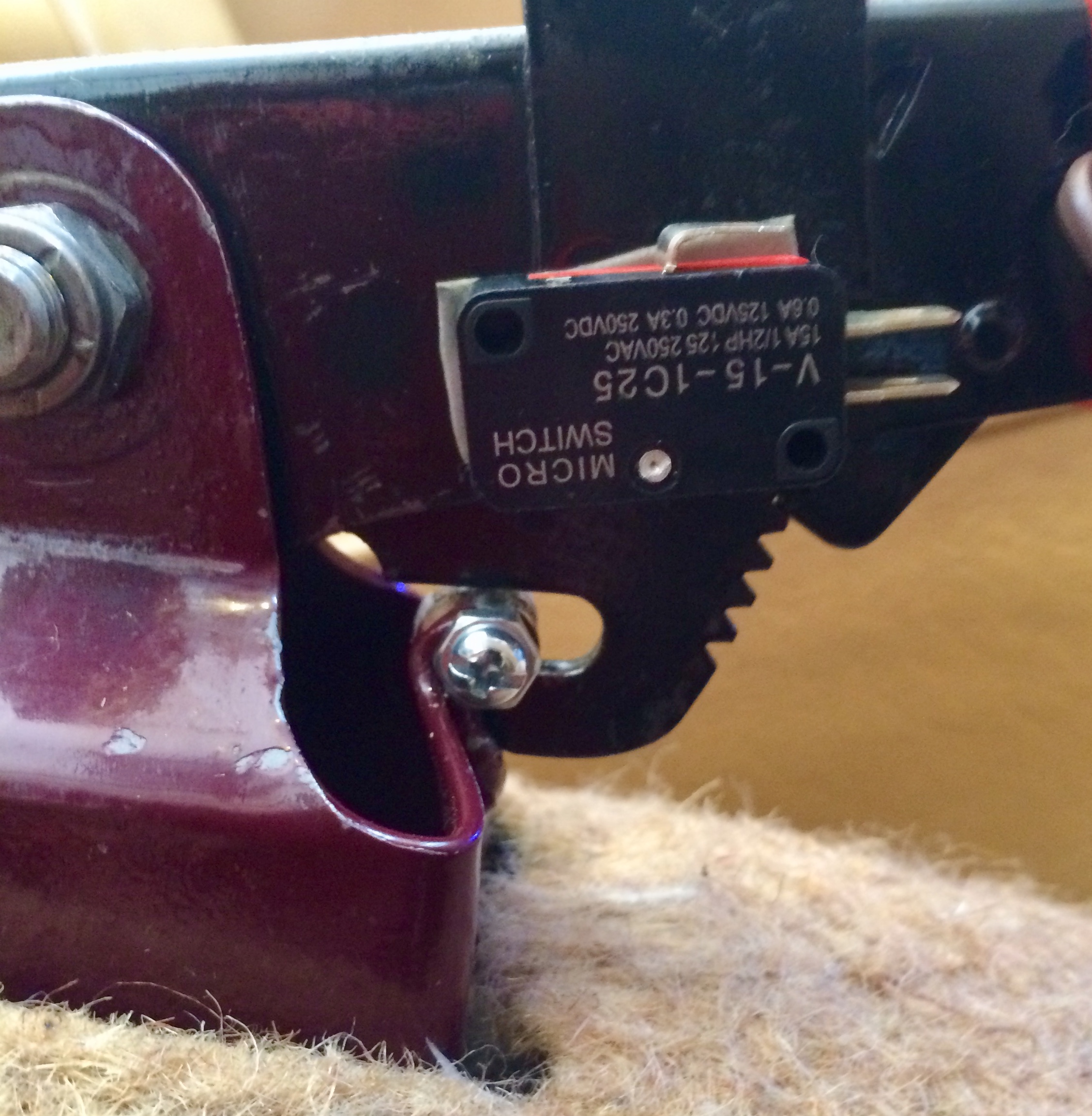

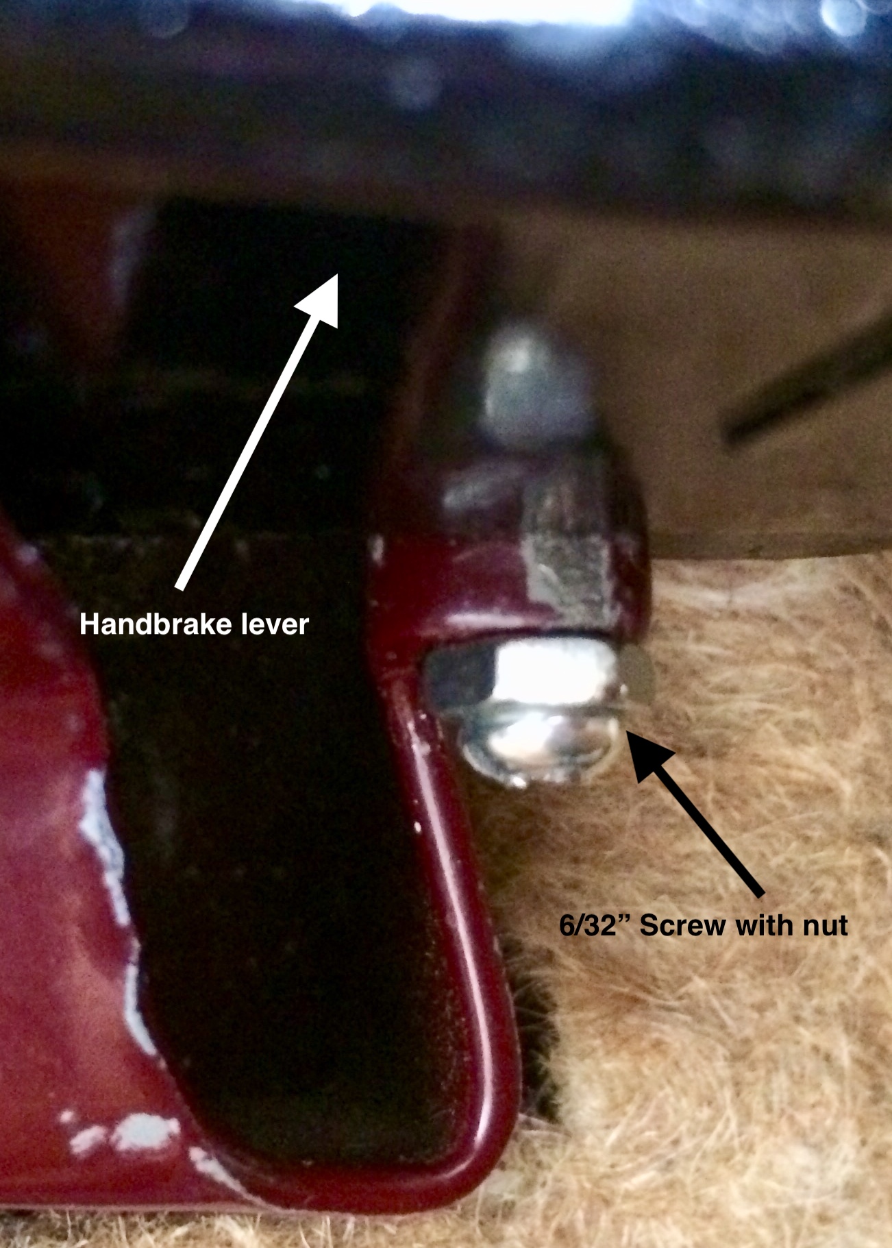

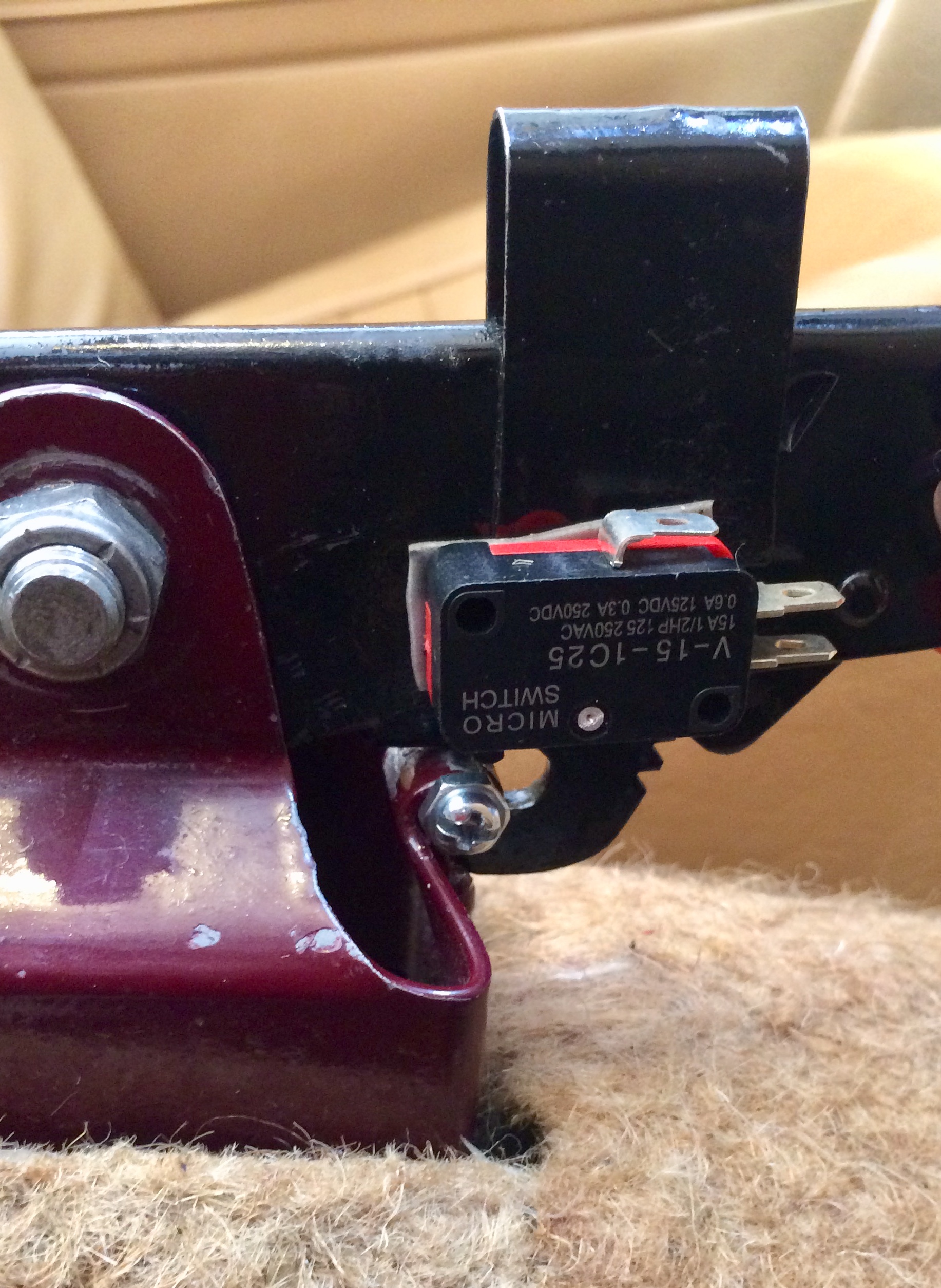

OK, I removed the mercury switch and went to a micro switch like Ed did. Since I did not want to disassemble my handbrake I decided to add a "stop" to contact the micro switch button. I was able to run a 6/32 tap into the base of handbrake. The flat on the nut was just enough area for the switch actuator to make contact with.
Lever in the down position
Lever raised
Gliderman8
Gliderman8
Looks like that will do the job, Elliot.
Ed
Thank you Ed. I looked at what you did (it looks GREAT!) and just couldn't bring myself to disassemble the handbrake. I also tried a proximity switch but finding a place to mount it and the magnet did not work. In the end, the added flat on the nut was all it took for the switch actuator to work.
