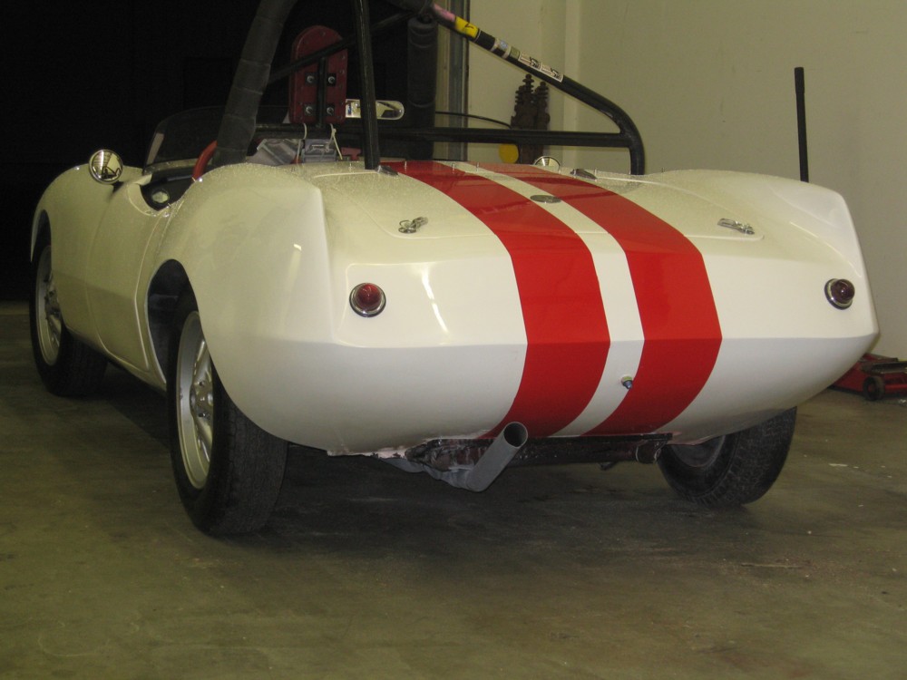

I have a 5# fuel cell in the back of the Elva which sits above a cross-tube and as a result the cell is above the floor of the boot (see photo of car from rear). I've thought about sealing up the floor to maximize the effect of the Halon system in the event of a fire. Does anyone have any thoughts here?

"""""Does anyone have any thoughts here? """""
There might not be a point of ignition in the rear area when using an FIA rated fuel cell and properly installed.
If you use a big Halon or AFF bottle you can put a nozzle back there but only if the bottle has a large capacity for a third location. The primary first two locations are the driver and the engine compartment.
If you use a non rated fuel tank as shown above ,not only should you pray but definitely use a large fire system with protection in the rear. Those tanks are questionable re intrusion protection and fire supression even with internal foam bricks, the bail handle caps often leak, and they might not have a cap flapper or rollover/vent valve in the vent line.
Using Halon you dont have to seal up every airhole and nozzle placement does not have to be from the top down as the gas will fill the entire area. With AFF you have to use top down (think showerhead) to saturate with the liquid.

Further to this--I currently have a 5 lb. Safecraft Halonite system installed with three nozzles: One in the engine compartment, one into the driver's footwell and one into the boot where the fuel cell is located. It is activated by the usual pull-handle located in the dash.
I'd like to follow Jeff's recommendation but do not have room for a larger bottle in the cockpit and have considered a separate 5 lb. bottle in boot. It seems to me that automatic activatation (heat or ionization sensor) would make sense and I wonder if anyone has any information on such a feature.
