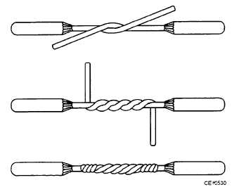

Having done electronics and auto electric for 40+ years, I would offer than crimp splices are NEVER as good as a WU splice and shrink tubing.
Mechanically, crimps will work loose with vibration.
BTDT.
ESPECIALLY on LBC's infested with Lucas, any joint done (or re-done) should be WU spliced and shrink tubed.
Yours is a little better than a stock crimp, as the shrink tubing will tend to keep moisture out a little better, but the crimp is still the crimp.
In a situation where there was no possibility of a WU splice, I have cut the plastic off crimps, crimped them on bare, soldered them, and srink-tubed them (or, if zero room, black taped them).
Those connections work 40+ years later.

What is a WU splice?
This is exactly what I did in my B. I've always joined two wires together this way just by instinct. Never realized it was a "formal" or "proper" way of doing it. :smile:
