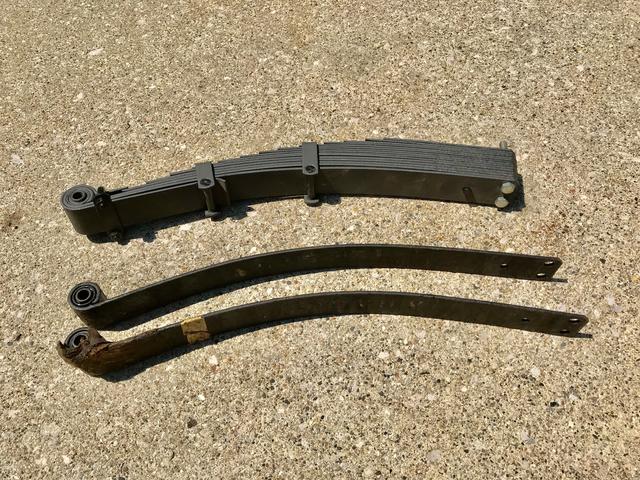

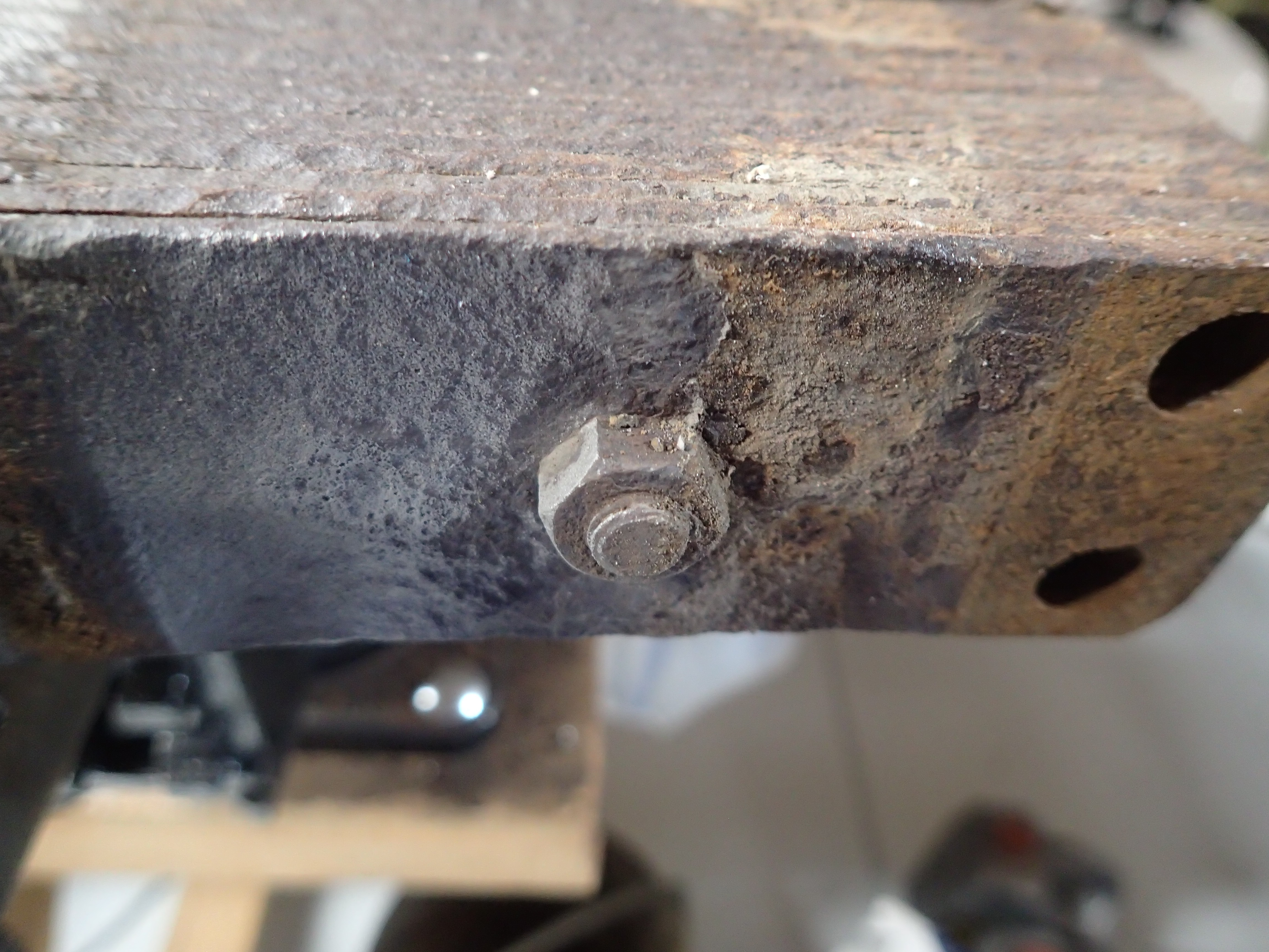

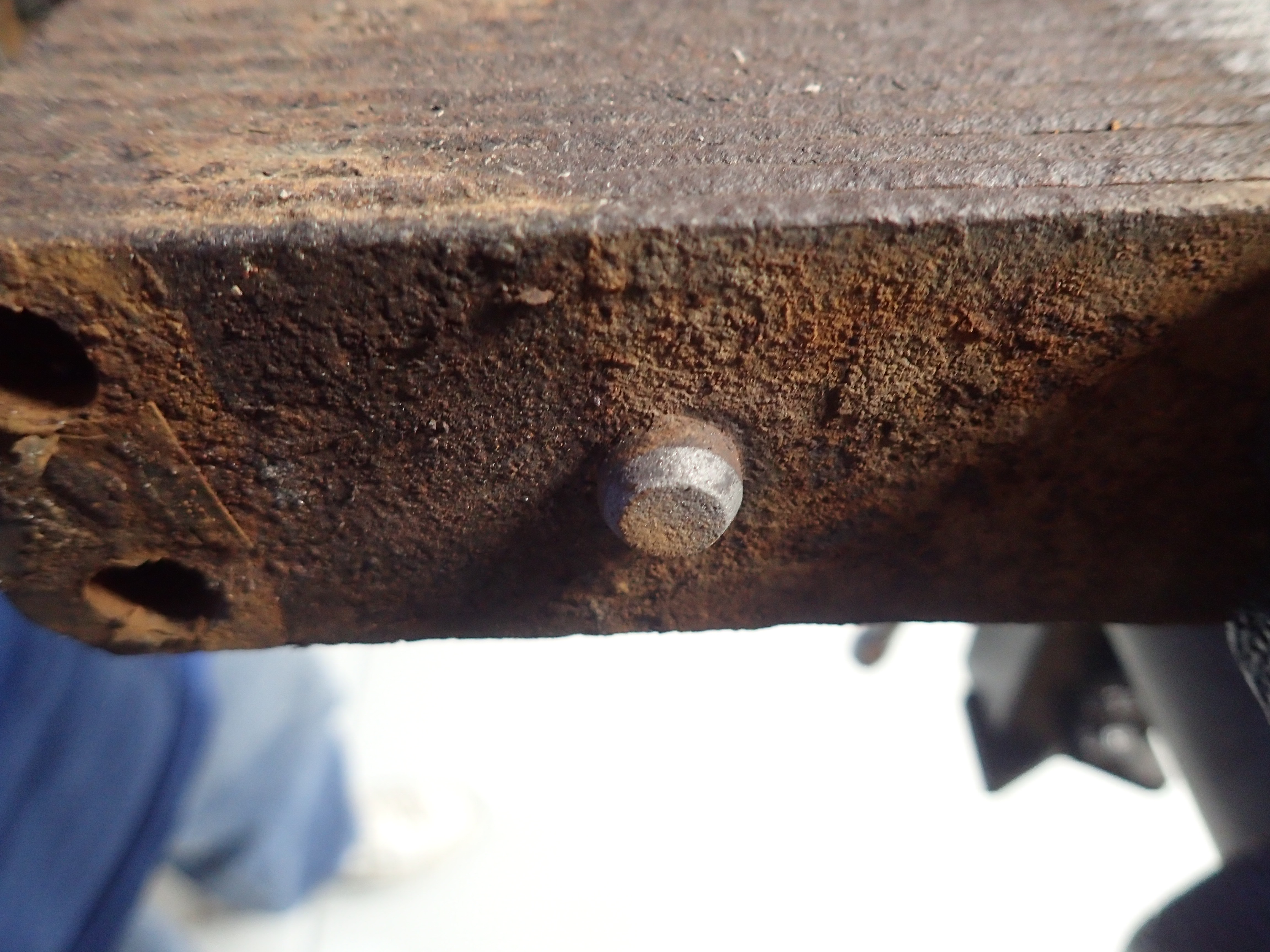

My leaf springs look OK, not bent in the wrong direction or horribly rusty. However there is a lot of road crud built up in mostly the top small springs. I can probably get that out with solvent (for road asphalt) and a thin slice of metal, but was also wondering if anyone has disassembled these springs. There is a weird looking bolt through the end which I suspect is pressed in somehow on one end and bolted on the other. If this could be removed it would make cleaning a lot easier. Can it?
Really not interested in buying new 10 leaf springs, mine are usable.

They can be disassembled, cleaned up, painted, and reassembled. The stud in your photo is used to line everything up and is actually just a bolt with a round head. The biggest concern is the hardware fastening the leaves together. The small clamps are usually rusted solid and you may have to find new screws, tubes, and nuts that hold the clamps together. The small U-bolts at the eye end of the spring are hard to find. Do your best not to break them. I coated the leaves in this set with a graphite impregnated paint before reassembly.

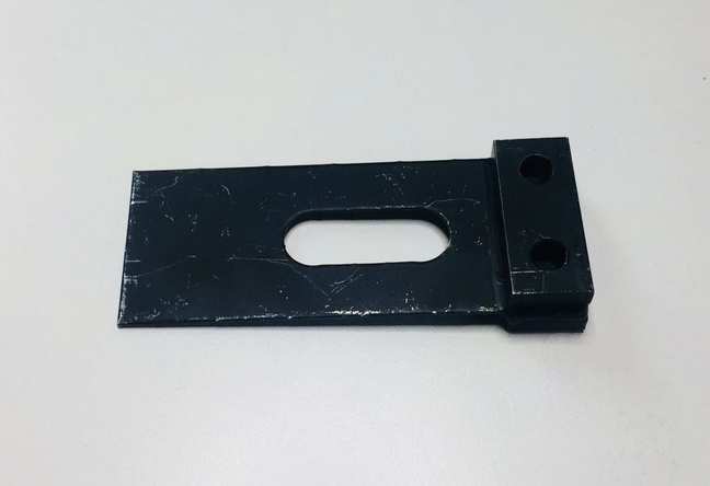

Great info, thank you! I also need a couple of those top spring plates as one is rusted away and the other is just missing. The bolt block seems ok, it's just the extended plate which looks suspiciously like a bench planer blade, which I may try since I am told these are on backorder forever.
