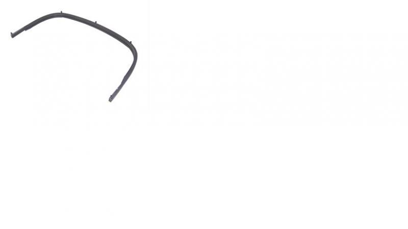

Can anyone supply the original part number for the drain channel ? Image attached
