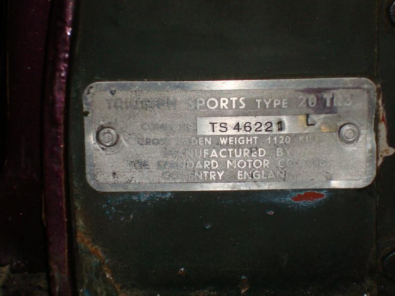

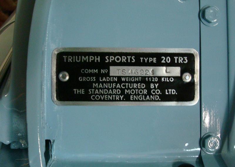

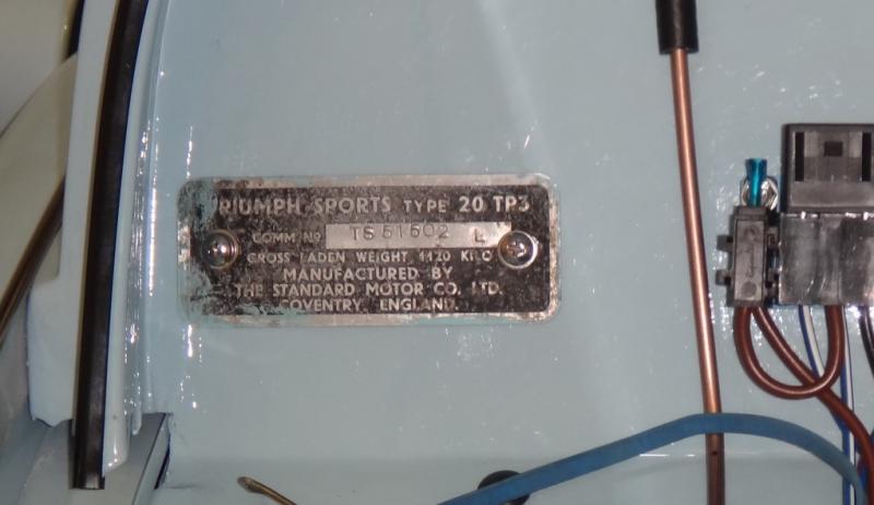

How bad are the originals? I bought new plates, but if you look closely the repro plates are not exact to begin with. I decided to resurrect my originals...
TR3a before.
Tr3a after.

Unlike the TR4s, the black portion of the TR3 commission plates are slightly raised allowing a crafty person (like John) to restore a stripped plate.
The TR4 plates are totally flat and (on LHD cars) thoughtfully placed right below the hydraulic reservoirs & M/Cs -- so they are often just bare metal with a stamped number.
I stamped mine with a simple jig. The font is not perfect ('3' has a round top rather than the original flat top) but the depth and crispness looked pretty good. I think I used a very hard surface under the plate:
Bo_Bogaty
I tried several times to duplicate my commission plate, but was never satisfied with the results. I finally noticed the letters on the original plate were raised which made restoring the plate relatively easy. A little black lacquer, 400 wet sanding, and clear coat did the trick.
