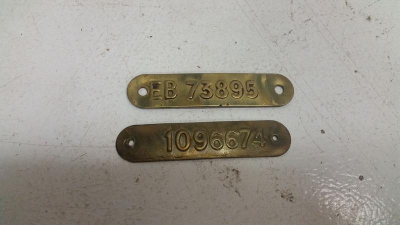

Do you mean these plates? One should be body colour. They look like they were stamped out on a machine similar to the one that would do name tags on railway stations.

Bob if you are looking for body tags like David has shown photo above
you might try emailing:
Frank Angelini
angelfj@verizon.net
he recently made tags for us. Unsure if he is still doing any more.
His quality is excellent. But you have to know your own numbers for him to emboss.
Gil. NoCal
