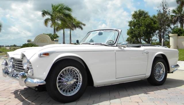

A car club friend's dark blue TR4A is what attracted me to the model. Beautiful color on the TR4 body style. I looked at a few in my hunt and ended up with a white one. It fit the saying to buy the best of what you like that you can afford! Never thought I'd buy a white car of any brand much less an old LBC but I think it is beautiful.
Cheers,
Irene
