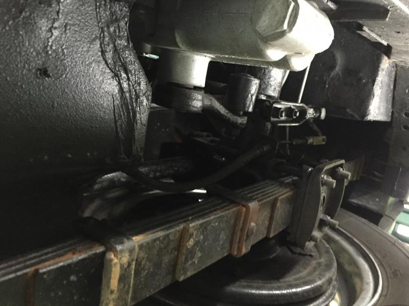

When there is a hole in the street which I did not see, when the back tyres detect it, I nearly jump so hard that I can look over the windsreen for a second.
Are there any things which could be defect or does anyone has an idea to improve the comfort level (Yes, I already have quite new and good seats) ? And it is not only the comfort, I have the feeling I am hurting also the chassis and the car.

At first glance, it looks like you are running 7 leaf springs and not the lighter more flexible springs designed for the BJ8 Phase 2. I would suggest you validate my first perception and, if correct, change back to the springs designed for your car. They will provide more flex and your frame was designed to provide more travel and a more compliant ride.
If I am correct, you have the springs designed for the straight frame of the BJ8 Phase 1 and earlier which are much stiffer and provide little travel.

Like Ray says, you may have too much spring. At rest the car should sit up off the frame rubber blocks a few inches at "midway" of the travel or so. If the springs are too long the travel at the rear trunnion may not be enough.

Those U bolts don't look correct to me , it could be the camera but what size AF are the nuts ? They look too big and heavy .

Steve, that locating plate is correct for late BJ8's. I think Ray has it right--he is running the earlier springs.
