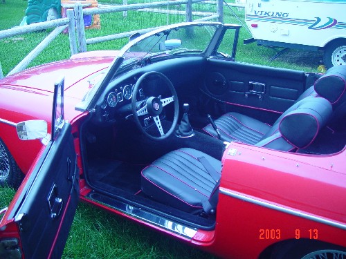

I went with prestige and they have a great kit. But the tranny tunnel is not moulded, but I didn't have problems working with it. The Tranny cover, floor mats and rear deck cover all have a nice think backing that helps with heat and noise. My entire interior is from them. They have great prices too. I did the leather seats too and love them. I will try to attach a photo.
