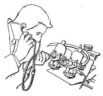

I like a cheap stethoscope with the amplifyer removed and the tube placed about 1/4 inch into the carb, keeping my hand far enough away so as not to block the air.
OPA, that looks interesting. I'll have to remember that one.

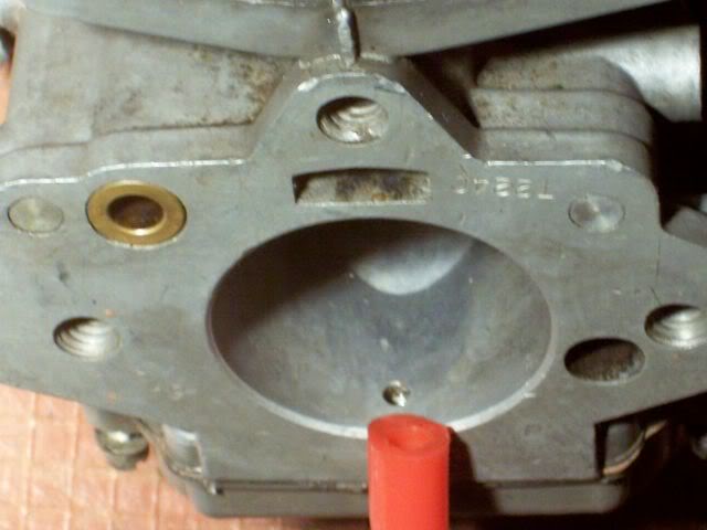

Personally..if I found a difference between the hiss and the Unisyn... I'd trust the hiss.
For the sake of consistency I use this thread hole in the ZS carb as a listening station.CarbSyncing.jpg
