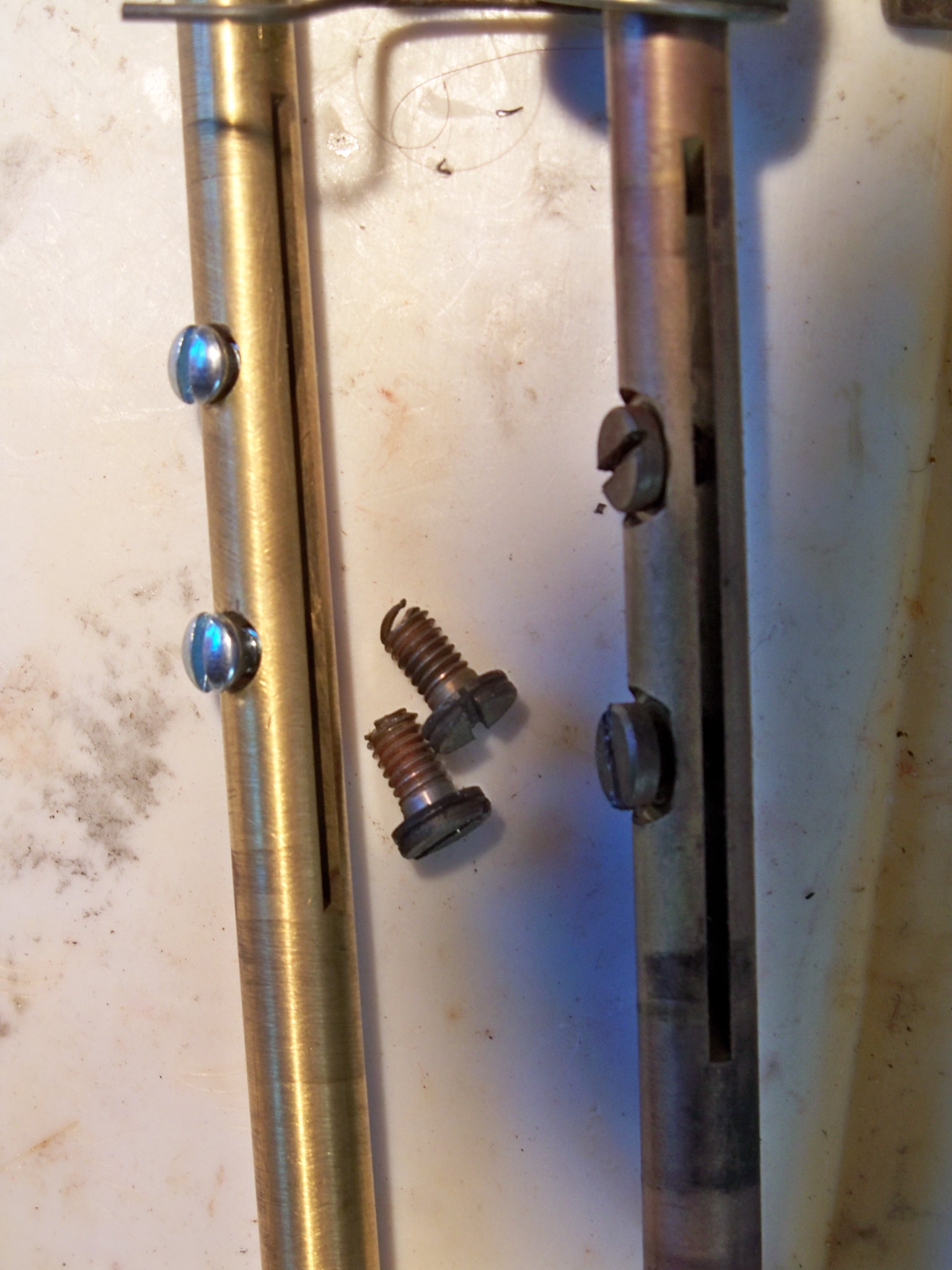

There are ZS throttle shafts that require a different screw....one and the most common and probably original is a flat head with a split at the tip of the threads to be spread as lock/..the other which I believe must belong to a replacement shaft because I see it so rarely is a rounded head, no split tip to lock so a thread locker is used.
When I go into the shop later today, I'll get pictures.
poolboy
Here's the picture...the bright ones are aftermarket, non-original...but upon close examination their tips also have the beginning of a locking split...and the threads are of a different size than original...not interchangeable

The aftermarket shaft looks like what I have. The screws are 5-40 with an oval head instead of the flat head. Talked to the folks at The Roadster Factory and the screws off of the SU carb on a Spitfire fit perfectly. Thanks for the info. The shafts fit too nicely to be a mistake.
