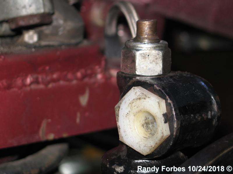

Again, before you could buy them, I made eccentric bushes for my upper trunnions, and I think I'm getting -1-1/2 to -2* negative camber. Are you sure the eccentric bushes are oriented to pull the top of the king-pin inward (sorry, HAD to ask...)?

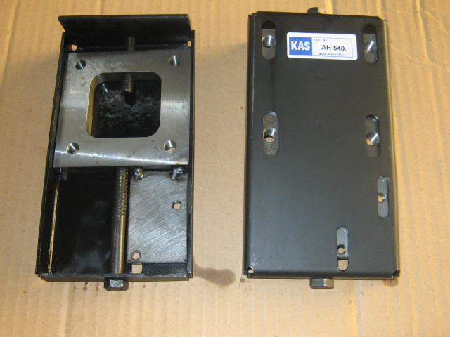

If you are talking about these...
They get welded all the way around - they replace the stock shock mounts.

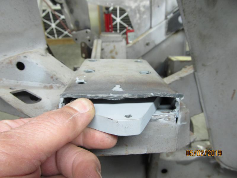

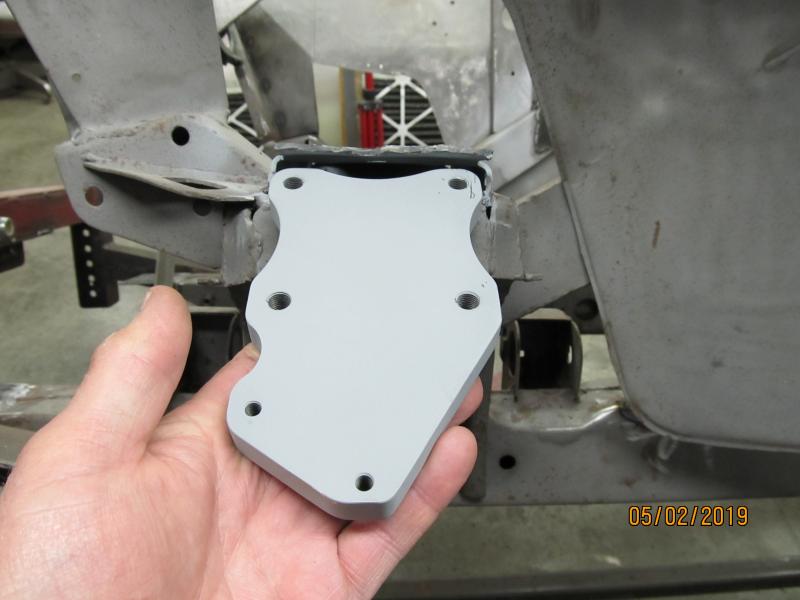

A lot easier way to go and cheaper is Tom's Import Toys adjustable plates - in that case you only cut open one end of the stock mount, knock out the welded nuts, slide the plate in and reweld where you cut it open.
The Kilmartin set does offer a much greater range of adjustment and is probably easier to change settings....

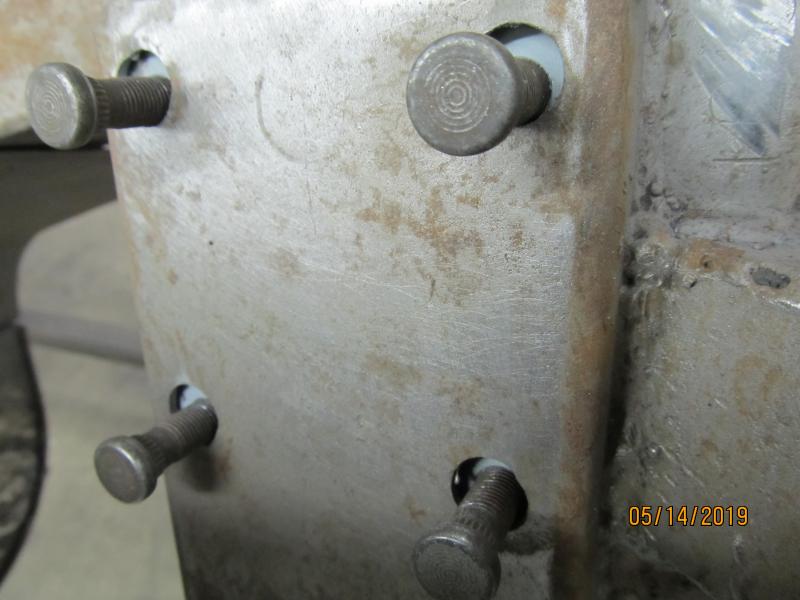

The holes in the mounts are 9/16" and the bolts are 3/8" so the potential total movement is 3/16" or 3/32" either way from centered. I think this will be enough to allow the 1/2 to 1 degree I am after, but, if necessary I will elongate as required.
I think this is probably enough in most cases unless the frame is way off.
I just installed a set of Tom's plates last week and I like how simple they are to install.

It's occurred to me that Tom's plates could have an additional advantage: they spread the load from the shocks to most of the plate, not just where the nuts are on a stock mount (they're sort of like a giant flat washer, spreading the load). I can't identify the physics involved, it just seems intuitive that they spread the bending and twisting loads over a greater area. Because of this, I think you could elongate and widen the holes in the shock plates to tweak both camber and caster.
